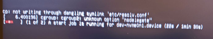

Sorry the delay, I got back to this Monday, but encountered issues so it took a while to sort through this. First, to your questions, yes, “system” means “devkit + SSD + PCIe card”, with configuration varying per experiment as we’ve discussed. So, I followed your request and did the following:
  1. I removed the SSD from each of the devkits
  2. Put them back together and powered them up…AGX1 appeared on LAN ssh, AGX2-4 did not, although the LEDs were all on and they drew power.
  3. I moved them to a different bench with monitor/mouse/keyboard, and while AGX1 booted to the desktop, AGX2-4 were stuck on a screen:
  4. After the 90 seconds it progressed as follows:
  5. It offered me the maintenance shell, so I accepted
  6. Obviously it was hanging up because I had pulled the SSD, so I commented out that line in /etc/fstab, rebooted, and it came up fine to the desktop. Repeated for the other two, same result.
  7. Put them back on the lan, now ssh worked fine in all 4.
  8. Without doing anything else, I captured dmesg, lspci, and ifconfig for all 4.
  9. I inserted the same Asus XG-C100C card, one at a time, into each system and captured the 3 logs again.
  10. To my amazement, ALL FOUR of the 10Gbe cards were now recognized as eth1, and had IP addresses.
  11. I rebuilt my cluster of 4 Jetsons, now each with their own 10Gbe card, and connected those onto a 10Gbe switch, the 5th port going to my LAN and laptop.
  12. All are accessible by ssh
  13. I used iperf3 to measure performance, which was working well, although only at 5.2Gbits/sec on average. I’m wondering why the performance is low, these are new CAT6 1.5 foot cables. But it does at least work!
So, I look forward to your insights as to why the PCIE cards don’t work when an SSD is installed, this is not very friendly? Now that I have the PCIE cards running, how to I get the SSDs back installed and everything playing together? What should I look for to debug the 10GBe speed issue, or is 5Gbits/sec to be expected? Why does the system crash when you remove the SSD drive, just because it has an entry (not the boot drive!) in the /etc/fstab?
I didn’t yet examine all the logs I collected, since it was working, but I will. I’m attaching all the logs in a zip.dmesg_logs.zip (160.4 KB)
