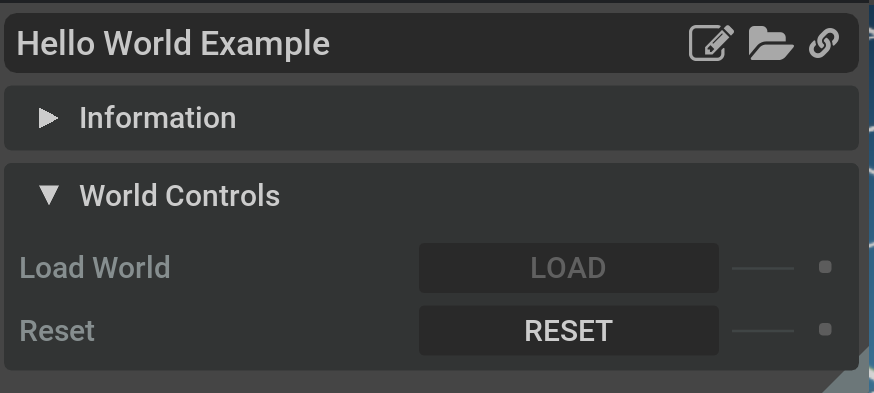

As per this tutorial page 3.3. Debugging With Visual Studio Code — Omniverse IsaacSim latest documentation
I am unable to move from
I guess this mean I can’t connect Isaac Sim with Visual Studio (don’t have a clue about status of Python at the moment - how to verify it ?)
In case you are going to ask, I have installed Code in the Exchange, but it is still showing red.

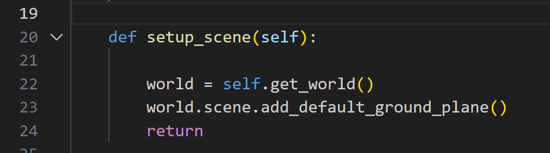

After the full reinstall of Windows (ver. 10, twice), I took my steps very slowly and never manually installed any Python interpreter, apart from what was already delivered with the Isaac Sim. Somehow the ‘Open source code’ button works, which makes all the difference.
This allowed me to tinker with the code of the scene. By commenting out the single line of code
world.scene.add_default_ground_plane()
I was able to check whether this line of code is linked with currently open scene, and it was - when the line was there the ground plane was loading; when the line was commented out, the ground plane was not showing up.

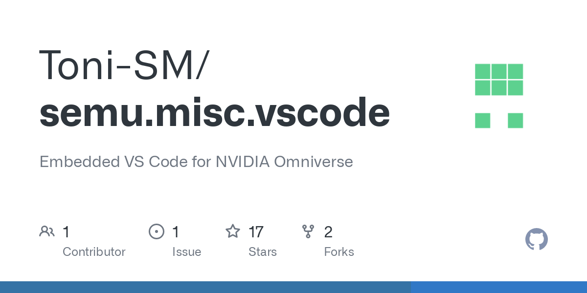

Hi @b.zarzycki1 - This extension will help you resolve the issue to connect VS code with Isaac Sim
In our upcoming release, we are planning to support this extension officially.
