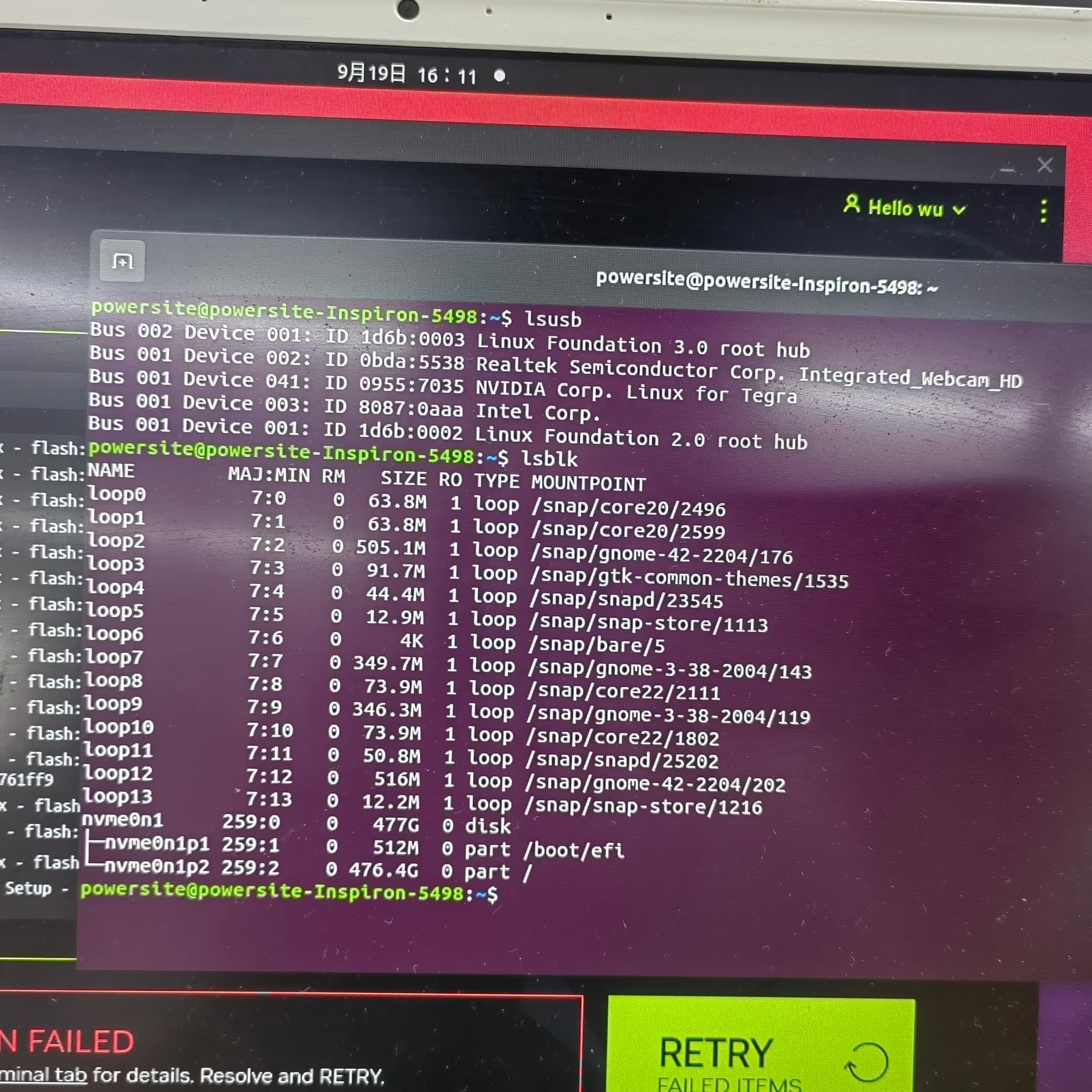

Error::Could not stat device /dev/nvme0n1
Please put the device into recovery mode first and then run the lsusb command on the host machine.
After that, follow the Quick Start guide to confirm whether the device is in recovery mode.
Bus 001 Device 041: ID 0955:7035 NVIDIA Corp. Linux for Tegra
My device is already in recovery mode。
$ sudo ./tools/kernel_flash/l4t_initrd_flash.sh --external-device nvme0n1p1 \
-c tools/kernel_flash/flash_l4t_external.xml -p "-c bootloader/t186ref/cfg/flash_t234_qspi.xml" \
--showlogs --network usb0 jetson-orin-nano-devkit internal
I ran the above command, but it still failed.
Error:Could not stat device /dev/nvme0n1
My device has already flashed, now I need to flash it again。I don’t know if the configuration environment of SDK Manage has been changed, it shouldn’t have been modified

Which JetPack version are you installing?
Is the NVMe physically connected to the board?
I am able to flash JetPack 6.2.1 to my Jetson Orin NX on CTI Boson carrier board with this flashing command:
sudo ./tools/kernel_flash/l4t_initrd_flash.sh --external-device nvme0n1p1 -c tools/kernel_flash/flash_l4t_external.xml -p '-c bootloader/generic/cfg/flash_t234_qspi.xml' --showlogs --network usb0 cti/orin-nx/boson/fsm-imx464-2cam internal
Can you confirm this file: bootloader/t186ref/cfg/flash_t234_qspi.xml exists? If not you can try using: bootloader/generic/cfg/flash_t234_qspi.xml

The error is Could not stat device /dev/nvme0n1 and there are several like issues reported, when using the SDK flashing to the NVMe storage fails. If the JetPack 6.2.1 was downloaded from the official site the file flash_t234_qspi.xml is there for sure!
Thank you for your reply.
I can confirm that the bootloader/t186ref/cfg/flash_t234_qspi.xml file exists
I am installing jetpack 5.1.4,flash failed when using the following command:
-c tools/kernel_flash/flash_l4t_external.xml -p '-c bootloader/t186ref/cfg/flash_t234_qspi.xml' \
The error message is as follows:
Error:Could not stat device /dev/mmcblk0 -No such file or directory.
There is a flash_t234_qspi.xml file available. However, using the SDK Manager flash device still failed,Could not stat device /dev/nvme0n1.
Thank you, I replaced the disk and it’s okay now
