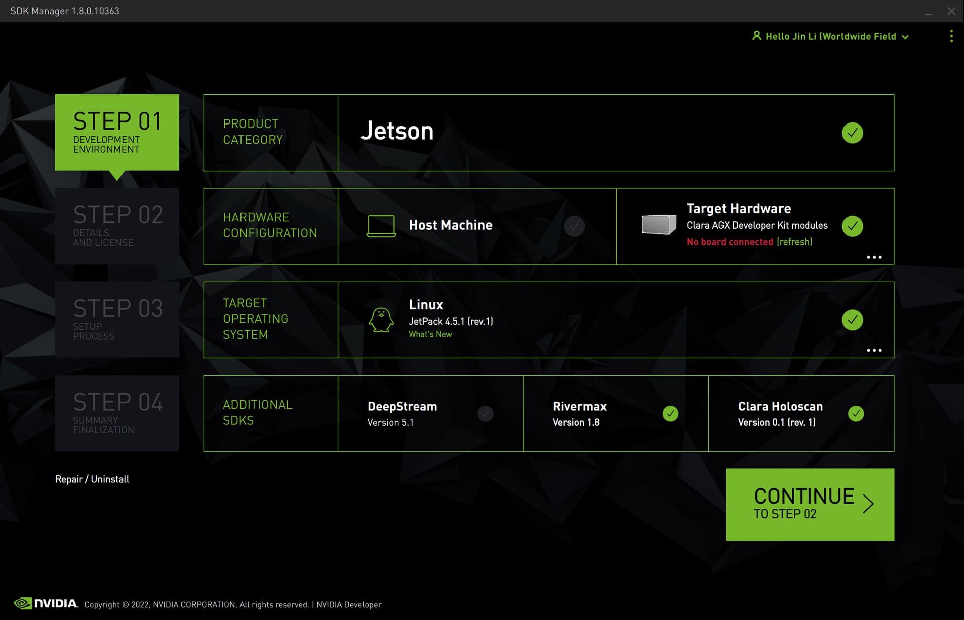

Hello, even though we strongly recommend users to move to v0.2, if you really want to install Holoscan SDK v0.1, you still can. First, flash your devkit with Jetpack 4.5 and select “Clara Holoscan” in Additional SDKs.
The source code for the GPU Video Test Source plugin is installed to the following path. /opt/nvidia/clara-holoscan-sdk/clara-holoscan-gstnvvideotestsrc
The problem is that I don’t have the option to select Clara Holoscan like you are showing in your picture, I can only install DeepStream. I also don’t have Rivermax option
My account permission in Membership Information says :
It sounds like it might be that the Target Operating System is selected as “JetPack 5.0 -HP” in this case. We need to select the older verison “Jetpack 4.5.1” in order for Additional SDKs to show Rivermax and Clara Holoscan as options.
It says “JetPack 4.5.1 (rev. 1) Not available for clara Holoscan Developer Kit modules” when I select Clara Holoscan developer Kit modules as my target Hardware
I see it says available on ubuntu 1604 and ubuntu 1804 for JetPack 4.5.1 (rev. 1) when i select Clara AGX Developer Kit modules as target Hardware. Do i really need to install ubuntu 1804 on my host machine to be able to flash my clara Holoscan with JepPack 4.5.1?

Hi there. Just to make sure, do you have a Clara AGX Developer Kit? It is not the same hardware as Clara Holoscan developer kit.
If you don’t have a ubuntu 18.04 machine around which is very understandable, perhaps you could try a VM as host, for example VMWare workstation. (We have not had success using VirtualBox in the past). Sorry for the inconvenience and we are planning on improvements with the setup process.
