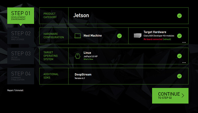

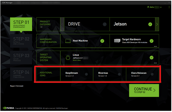

I don’t have the settings of Additional SDKs on the first step SDKmanager to install the Clara Holoscan (Deepstream and Rivermax) as shown in the youtube set up tutorial Clara AGX Developer Kit Unboxing and Setup - YouTube.
Hello, for now, please apply to the developer program and log into SDK Manager with the same account that you used to apply. Then the Clara Holoscan SDK option should show up. Please see the Download section on our https://developer.nvidia.com/clara-holoscan-sdk page for applying to the developer program.
Hello, with the latest release of Jetpack 5.0 - HP, please note that Rivermax for Clara Holoscan is no longer part of the SDK Manager installation, and you can follow the latest devkit user guide on installing the Clara Holoscan SDK via GitHub.
