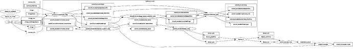

I am using a USB camera with a Jetson Orin Nano to run yolo. I start my usb cam and remap the output topic to /image and /camera_info. I then followed the yolo quickstart but do not get any output. I have attached my rqt graph. I ran the command ros2 launch isaac_ros_yolov8 isaac_ros_yolov8_visualize.launch.py with the both the model and engine file paths specified.
Hello @kohmacht thanks for your post. It seems like you’ve encountered the issue of topic name mismatch. Based on the rqt_graph you provided reveals that while the isaac_ros_yolov8_visualize launch file is expecting input on the /image topic, your usb_cam node is still publishing its image data to a different topic /image_raw. Because these topics do not match, the YOLO detector node never receives any images from your camera, which is why you are not getting any output.

Hi, I used the second option to remap the topic. I figured out that the yolo model file was not properly configured and rebuilt the plan file to fix it. It worked for me.
