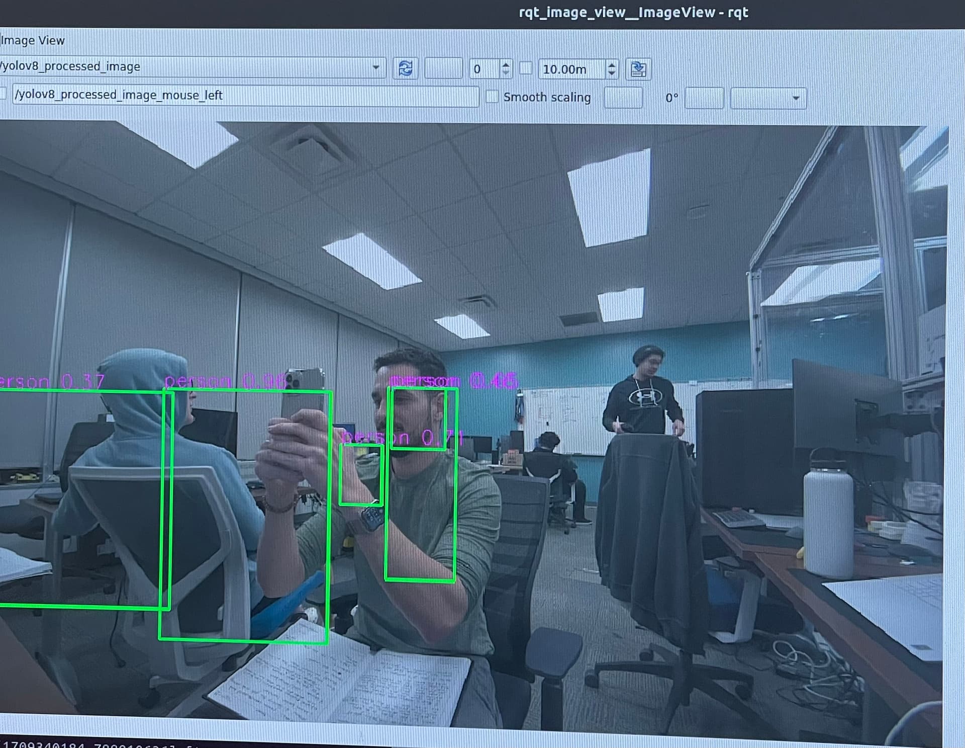

Hello, I am working on a project that requires me to use a custom trained object detection algorithm and have it publish the bounding box coordinates along with the class on to a ros topic so i can control a vehicle based on that information. I have been following the instructions in the isaac_ros_yolov8 tutorial and i was wondering if anyone could guide me on how i can inject a live feed instead of a single image like in the tutorial.
Thank you that helped me out immensely. i was able to publish to the /image topic with a custom node but the issue im running into now is that the topic that is able to provide bgr8 (which is what /image is expecting) /zed/zed_node/left_raw/image_raw_color/compressed is publishing messages of type sensor_msgs/msg/CompressedImage , not sensor_msgs/msg/Image. This discrepancy is causing an issue with the subscription and publishing, as isaac_ros_yolov8 node is set up to handle Image messages, not CompressedImage messages. if i try then to decompress the image with my custom bridge nose shown here:

it actually works but i get a weird output that seems to have the bounding boxes shifted over to the left, and the further you are away from the camera the more to the left the bounding boxes get shifted. here is a picture show what im talking about as its hard to describe.
as you can see here the bounding boxes for the people in the back are pushed so far to the left that they are covering the person taking the picture, and the bounding box for the person taking the picture is to his left by his hands and so on. the further back you are the more to the left the bounding boxes appear. the only way i can test to see if its because of the decompression being done by cv2 is to feed the compressed files but i cannot.
is there a way of configuring the isaac_ros_yolov8 node to subscribe to a different, unique topic for its input images, rather than /image . or can we change the type that its expecting to CompressedImage?
I suggest rewriting your launch file and remapping the image subscriber with a new name. I also recommend using our package Isaac ROS Image Pipeline — isaac_ros_docs documentation, where you can find different packages for image processing.
thank you @Raffaello! it looks like im going to have to use the Isaac ROS Image Proc since simply remapping the nodes wont change the type they are expecting. but i was looking at it and the ZedX mini camera isnt in the other supported cameras list and realsense is the only other camera mentioned. Does this mean ZedX mini isnt supported or simply not mentioned.
