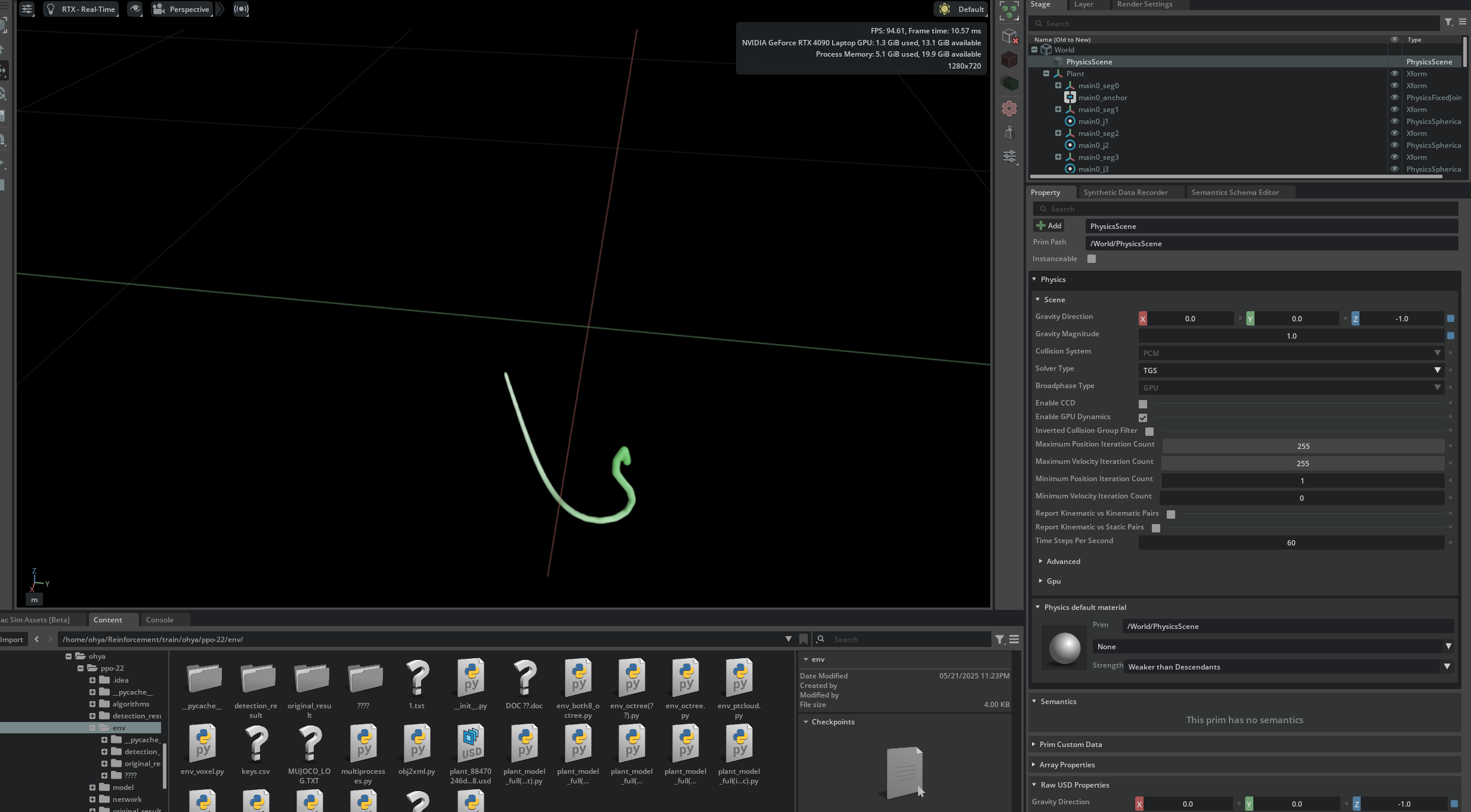

Hi @zhaowentao, thank you for posting your question. The reason why the spherical joints are not exhibiting elastic behavior is because Joint Drive is not currently enabled for Spherical Joints, only for Revolute, Prismatic and 6D joints.
I actually adapted one of my rope scripts to try to simulate what you are trying to do. Here is the outcome I am getting.
This is the script I am using:

        return self.segments
    def get_joints(self):
        """Get all joint prims for the rope"""
        return self.joints
    def get_first_segment(self):
        """Get the first segment prim for the rope"""
        return self.segments[0] if self.segments else None
    def get_last_segment(self):
        """Get the last segment prim for the rope"""
        return self.segments[-1] if self.segments else None
# Create a world
my_world = World(stage_units_in_meters=1.0)
# Add default ground plane
my_world.scene.add_default_ground_plane()
# Get the stage
stage = simulation_app.context.get_stage()
# Enable Physics
scene = UsdPhysics.Scene.Define(stage, "/physicsScene")
scene.CreateGravityDirectionAttr().Set(Gf.Vec3f(0.0, 0.0, -1.0))
scene.CreateGravityMagnitudeAttr().Set(9.81)
physx_scene = PhysxSchema.PhysxSceneAPI.Apply(stage.GetPrimAtPath("/physicsScene"))
physx_scene.GetTimeStepsPerSecondAttr().Set(120)
# Create default prim and physics material
default_prim_path = Sdf.Path("/World")
UsdGeom.Xform.Define(stage, default_prim_path)
stage.SetDefaultPrim(stage.GetPrimAtPath(default_prim_path))
# Create the rope creator and generate ropes
physics_material_path = default_prim_path.AppendChild("PhysicsMaterial")
UsdShade.Material.Define(stage, physics_material_path)
material = UsdPhysics.MaterialAPI.Apply(stage.GetPrimAtPath(physics_material_path))
material.CreateStaticFrictionAttr().Set(0.5)
material.CreateDynamicFrictionAttr().Set(0.5)
material.CreateRestitutionAttr().Set(0)
rope_creator = RopeObject(stage,
                           default_prim_path,
                           physics_material_path,
                           pivot_point=Gf.Vec3f(0.0, 0.0, 2.0),
                           rope_length=2.0,
                           link_half_length=0.2,
                           rope_damping=10e6,
                           rope_stiffness=10e12,
                           rope_segment_mass=10e-6)
rope_creator.create_rope()
# Create a Fixed Joint between the first capsule and the world
# Get the first capsule path
first_capsule_path = "/World/Rope/capsule_0"
first_segment = rope_creator.get_first_segment()
# Create a fixed joint to anchor the first segment to the world
anchor_joint_path = default_prim_path.AppendChild("anchor_joint")
anchor_joint = UsdPhysics.FixedJoint.Define(stage, anchor_joint_path)
# Set the first segment as body1 (body0 will be the world/ground)
anchor_joint.GetBody0Rel().SetTargets(['/World'])
anchor_joint.GetBody1Rel().SetTargets([first_segment.GetPath()])
# Set the local position for the anchor joint
first_segment_position = first_segment.GetAttribute("xformOp:translate").Get()
anchor_joint.CreateLocalPos0Attr().Set(first_segment_position)  # Local position on the first segment
# Initial setup for the simulation
timeline = get_timeline_interface()
# Start the simulation
timeline.play()
# Wait for the simulation to start
while not timeline.is_playing():
    simulation_app.update()
    time.sleep(0.01)
# Keep the simulation running
print("Simulation started. Press Ctrl+C to exit")
position = 0.0
try:
    while timeline.is_playing():
        time.sleep(0.01)
except KeyboardInterrupt:
    print("Simulation stopped by user")
finally:
    # Stop the simulation
    timeline.stop()
    simulation_app.close()
Hope that helps!
