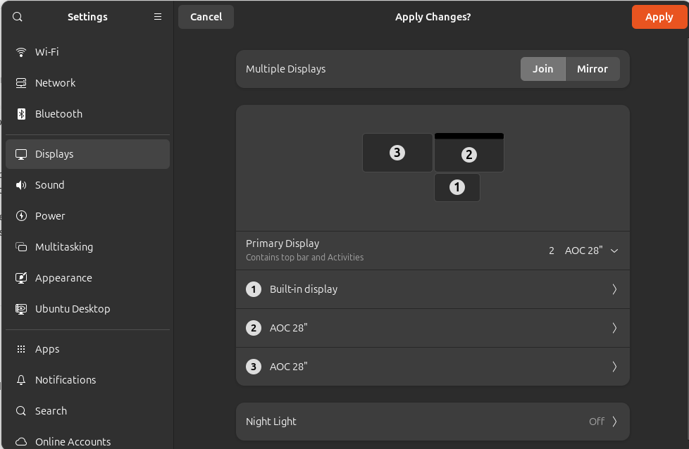

Please share your display configuration for the freeze behavior, as it might give some insight. I notices that Isaac (in Ubuntu) prefers if all of your displays are aligned on the top portion of your screen. However, with 2 monitor configurations, I was not able to replicate the behavior.

I’ve tried multiple things but the most stable so far is installing on Ubuntu 24.04. For the first run I had to disable my laptop display
After the first run reenable the main display but make sure the tops of all monitors are lined up

if you have multiple GPUs (intel, nvidia)… try setting the nvidia as the primary one, that solved the issue for me.
sudo prime-select nvidia
sudo reboot
