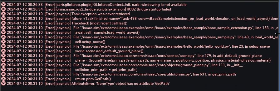

hello , i’m facing an issue when i want to run isaacsim headless webrtc container on a server and getting GUI on chrome browser, i can get a graphic interface now , but when i want to run a example on isaac sim , its stuck.
Hi. Do you have access to the Internet and have a local Nucleus server installed?
Please try running Isaac Sim headless with the -vv flag. You may find more info on the errors.

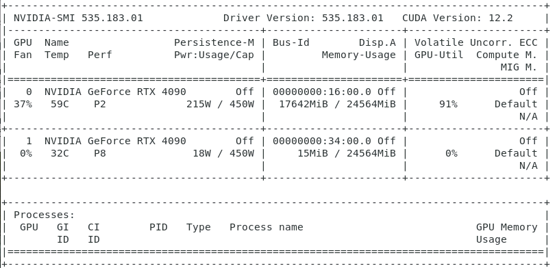

I’m wondering is it because of the driver version?
I’m trying to run isaacsim on a remote workstation and show desk env with windows remote control software
hello, i tyied also use -vv flag
here is the log

2024-07-18 14:08:29 [171,839ms] [Info] [carb.omniclient.plugin] HTTP Client: http: libcurl error (56): Failure when receiving data from the peer for http://dcb18d6mfegct.cloudfront.net/Assets/Isaac/4.0/Isaac/Environments/Grid/default_environment.usd
2024-07-18 14:08:29 [171,839ms] [Verbose] [carb.omniclient.plugin] HTTP Client: http: http://dcb18d6mfegct.cloudfront.net/Assets/Isaac/4.0/Isaac/Environments/Grid/default_environment.usd retrying in 105ms
2024-07-18 14:08:29 [171,839ms] [Verbose] [carb.omniclient.plugin] HTTP Client: http: GET http://dcb18d6mfegct.cloudfront.net/Assets/Isaac/4.0/Isaac/Environments/Grid/default_environment.usd (timeout=60)

2024-07-18 14:09:15 [218,028ms] [Info] [carb.omniclient.plugin] HTTP Client: http: libcurl error (56): Failure when receiving data from the peer for http://dcb18d6mfegct.cloudfront.net/Assets/Isaac/4.0/Isaac/Environments/Grid/default_environment.usd
2024-07-18 14:09:15 [218,028ms] [Verbose] [carb.omniclient.plugin] HTTP Client: http: http://dcb18d6mfegct.cloudfront.net/Assets/Isaac/4.0/Isaac/Environments/Grid/default_environment.usd retrying in 285ms
2024-07-18 14:09:15 [218,028ms] [Verbose] [carb.omniclient.plugin] HTTP Client: http: GET http://dcb18d6mfegct.cloudfront.net/Assets/Isaac/4.0/Isaac/Environments/Grid/default_environment.usd (timeout=60)
