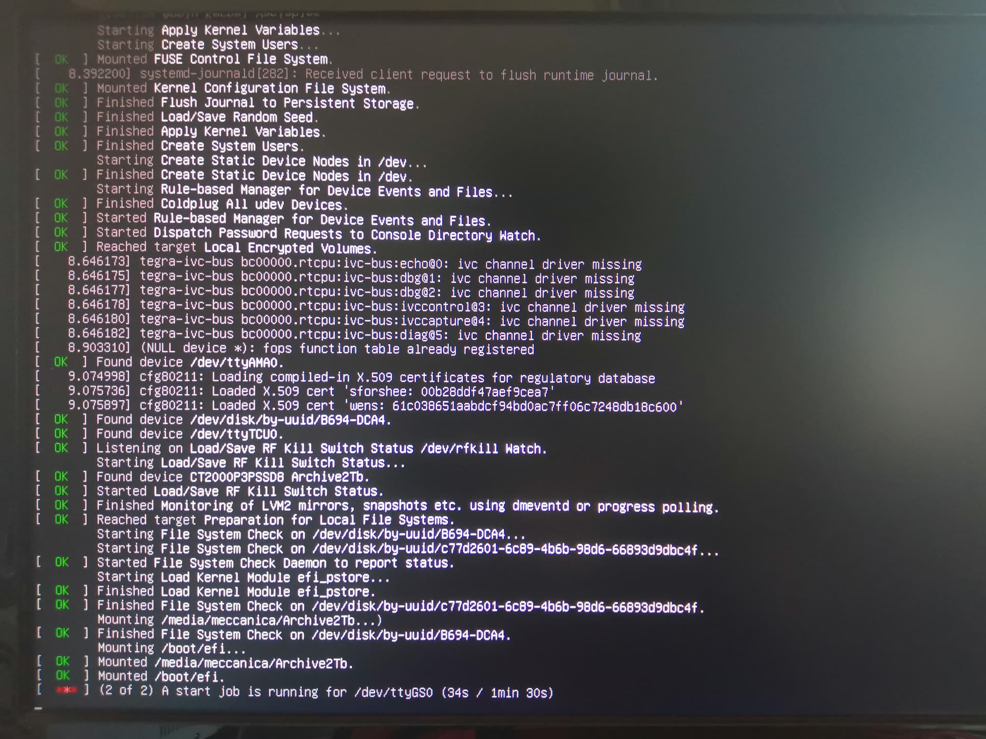

I purchased a Jetson AGX Orin 64GB Developer Kit on July 23, 2023, and unfortunately, I believe the GPIO port may now be damaged.
I’m using JetPack 6.2. To configure the GPIO pins for high/low output, I attempted to modify the Pinmux settings following the JetsonHacks tutorial. However, after each reboot to apply the changes, the system fails to boot properly. It shows the following errors:
  • "No root-device: Mount failed"
  • "VDD_3V3_PCIE: disabling"
  • "VDD_12V_PCIE: disabling"
Eventually, it enters emergency mode and stops there.
Additionally, when trying to pull a pin high using sudo gpioset gpiochip0 51=1, the voltage did not change as expected. I then measured the voltage on all GPIO pins — some read 3.3V, some 0V, and others somewhere between 2.8V and 3.3V. This inconsistency made me suspect that the GPIO port may be damaged.
Is there any way to have this device repaired, or to get support for such hardware issues? The device is quite expensive, and I would really appreciate any advice on next steps.
Thank you!

Hi baisihua,
I think we should check the boot issue first.
Do you mean it can boot before you apply the change in pinmux?
You can simply use SDK manager to flash clean Jetpack6.2.
It seems your devkit can work as expected in past 2 years.
Do you know what may cause current boot and GPIO issue?
Please also share the full serial console log for further check.
Hello, KevinFFF. Thanks for your attention and support.
Yes, it can boot and function normally as long as I don’t modify anything related to GPIO. In fact, I successfully ran a video depth estimation using Depth Anything v2 for 1 minute without any issue.
Yes, I did exactly that. We are going to use YOLO11 this year, which requires JetPack 6. So, I freshly flashed the Jetson using the SDK Manager. And then I started to use GPIO and got the issue. I have to say that the GPIO configuration in JetPack 6 is significantly different from JetPack 5. After three days of trials, I began to realize the GPIO ports might have gone wrong.
This is a shared device in our team, so I can’t be certain what exactly caused the GPIO issue. I’ll investigate further.
Last year, I used the GPIO ports under JetPack 5 without problems for my own project. But, you know, GPIO pins are quite fragile, which usually work within 10 mA. On a cheaper board like Raspberry Pi, this kind of issue wouldn’t be a big deal. But this Jetson is a $2000+ piece of hardware. So, I’m personally concerned about the design of the GPIO ports. I think using a dedicated external GPIO expansion module would be a safer and more robust solution — just my personal opinion.
Currently, to proceed with my project, I’ve already purchased a third-party USB-to-GPIO module, and it worked well. So, the issue is not fatal, so far.
I suspect that there is a power-related failure on the GPIO rail, which then affects other power domains and prevents the system from rebooting correctly if I try to use the GPIO ports. It is just my guess, as I’m not an electrical engineer.

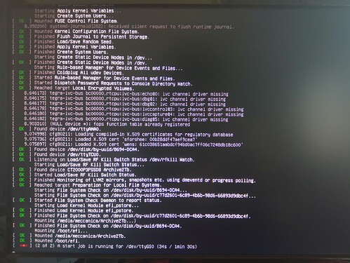

Below are photos of the log captured during the failed reboot. I hope this information helps with further diagnosis.
Once again, I would like to express my sincere gratitude for your concern and assistance!
Please share the log as file instead of the screenshot.
You can refer to NVIDIA Jetson Orin AGX - In Board - Getting in Board - Serial Console to capture serial console log.
I think the board should be fine if it can work/boot after using SDK manager to flash.
To control GPIO in JP6, you need to do the following 2 things.
  1. configure the pin as Output or Bi-directional in pinmux spreadsheet.
  2. apply the patch from 40hdr - SPI1 gpio padctl register bit[10] effect by gpiod tools in JP6 - #20 by KevinFFF
Please let me know if above methods can help for your case.
