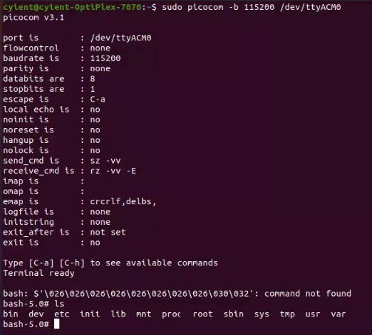

Jetson AGX Orin is not properly booting after flashing OS image for R35.2.1

after Terminal ready getting in cmd , it is taking so much time to execute …
Yes, we r using type-C for power up the Orin board & micro usb is connection b/w host & board

Looks like you bumped into some issues with the rootfs, and I’m not sure why you got these OTA stuff in the log:
[   10.197208] Run /init as init process
[   10.209460] Root device found: initrd
[   10.209914] Mount initrd as rootfs and enter recovery mode
Finding OTA work dir on external storage devices
Checking whether device /dev/mmcblk?p1 exist
Looking for OTA work directory on the device(s): /dev/mmcblk0p1
Checking whether device /dev/sd?1 exist
Device /dev/sd?1 does not exist
Checking whether device /dev/nvme?n1p1 exist
Device /dev/nvme?n1p1 does not exist
Finding OTA work dir on internal storage device
[   10.245018] EXT4-fs (mmcblk0p1): warning: mounting fs with errors, running e2fsck is recommended
[   10.247180] EXT4-fs (mmcblk0p1): mounted filesystem with ordered data mode. Opts: (null)
OTA work directory /mnt/ota_work is not found on /dev/mmcblk0p1
OTA work directory is not found on internal and external storage devices
Can you please try re-flashing again with SDK Manager?

So can I re-flashing again with same process or with SDK manager ?
I suggest also trying SDK Manager.
OK, sure, we will try with SDK manager also once, thank you…
Yes, now we are able to install OS image with SDK manager,
Thank you for ur support …
