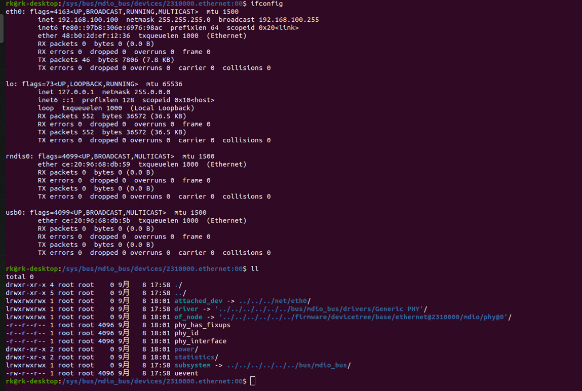

Hi,We used RGMII interface on our custom board connected TI 100M phy(DP83TC812),but the network is disconnected.We tested the TX_CLK and found it was 125M.
The TX_CLK of 100M phy should be 25M, how do we configure this TX_CLK to 25M?Thanks!

The system dmesg result is
dmesg.txt (86.3 KB)
eth0 can be found
But the network cannot be pinged.

The dp83tc812 driver has been compiled into the system as a module.
But this phy driver is still using Generic PHY
Could you please help us see what the problem is?Thank very much!
