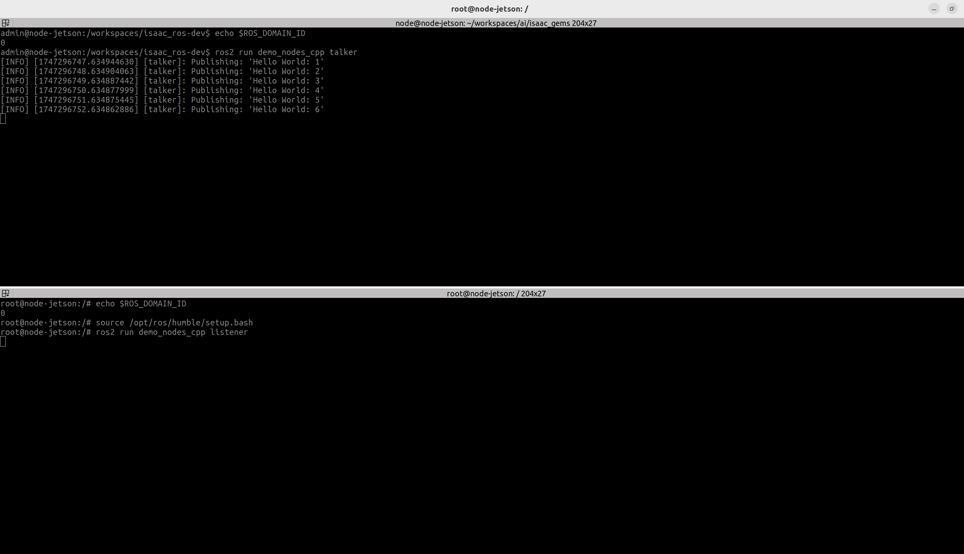

I tried what you suggested but I am not able to access the data in the topic. In the screenshot, the top terminal is the isaac-ros-dev container and the bottom container is a ros:humble container pulled open-source. The ros:humble container was launched with network=host like docker run --network=host -it ros:humble bash.
I am able to see the topics from Jetson via ros2 topic list, but not able to access it.
Please suggest next steps.
HI,
It worked when I exported the same rtps_dds_config in the other container. I have one more question before closing the topic.
