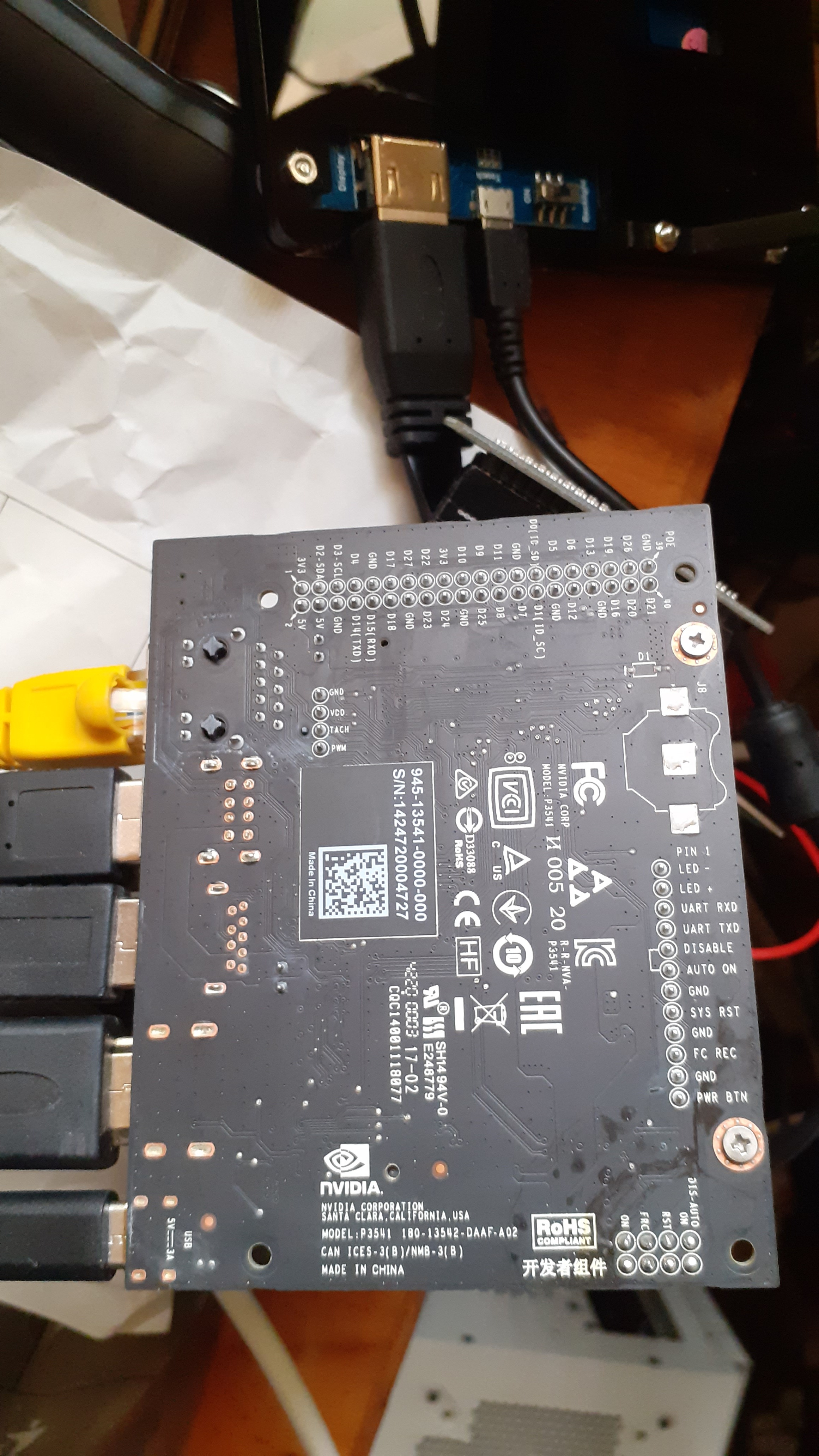

It’s a Waveshare Jetson Nano 2GB from Amazon UK. USB used to work until about a month ago. I am going to burn a new microSD card with the file I used jetson-nano-2gb-jp461-sd-card-image.zip
Does Waveshare produce alternate software? It seems likely that the power rails are wrong because of using the dev kit software instead of the Waveshare software. It’s critical to find out from Waveshare what the flash procedure is. It is possible that an SD card image might work without reflash, but even if that is the case, then the boot content would have to be a valid release for that SD card. Most of the time if something like USB fails in this way we would be telling you to flash the module itself (with Waveshare’s software), which is separate from the SD card, and which contains the device tree.

I can’t find the order. I wonder if this is one of your boards, says
NVIDIA on the back.

It is waiting for you to complete first boot setup to log in. Your touch screen is not configured or set up on any default Jetson, so screen touches won’t do this. You’ll probably need either serial console to finish this, or an actual keyboard/mouse. Touchscreen setup could require a number of things depending on how it works, e.g., maybe it is just a USB configuration, but it could use GPIO in which case it needs a device tree edit. If the touchscreen comes with this, then this isn’t something NVIDIA sells despite the module being NVIDIA’s.
Waveshare does make its own products for mounting modules onto. I suspect the carrier board is their own. There is no way to know if their carrier board exactly matches the NVIDIA reference design (in which case no device tree edit is needed), or if there are differences (in which case the device tree needs editing and Waveshare would provide this).
Note: A USB touchscreen failing is not the same as USB failing. Have you tried an actual USB mouse and keyboard?
