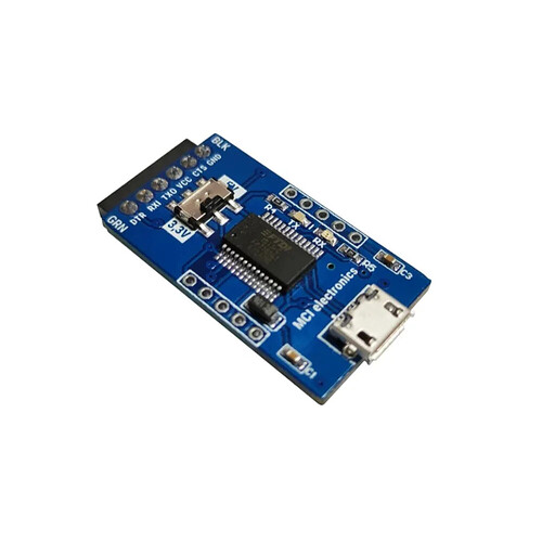

I followed all the instruction to flash the sd-card (in windows) successfully. I have RaspberryPI 5v-2.5A micro-usb power supply. At the boot, I see Nvidia logo on the screen but after few seconds screen goes blank. Power light is still green and ethernet cable is showing activity. The device heat-sink is warm. But no output, I am stuck. Any help is appreciated. BTW. can someone explain how to get serial output log?

Take the booting process from the serial port or use the dmesg command as root (or use sudo).
But I dont see any serial port on the board.

Thanks for the video link. I am trying to find ttl-to-usb connector at my place. I will update you as soon as I am able to get the boot log.
Someone has already shared boot screen. Any update to what is preventing nano to boot?
Btw, I used this Serial to USB board, the pinout fits perfect for the nano.
