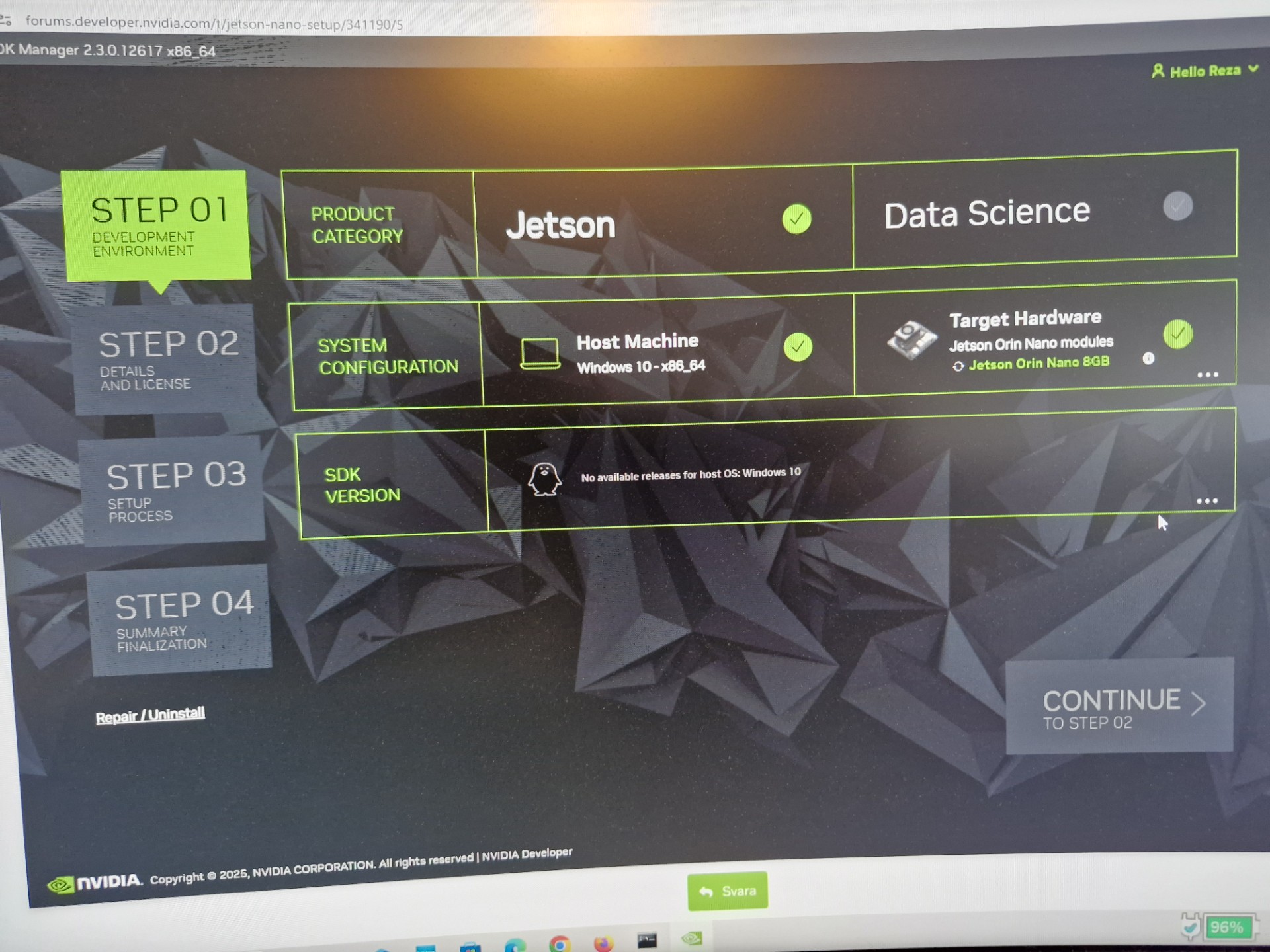

I downloaded the SDK manager for windows. I installed “APX Driver” and I put the jetson nano in recovery mode, and I started the SDK manager. the below picture is what came up. It identifies the Host machine correct and it detects the connected hardware (Jetson Orin Nano) correctly. But, no SDK version are clickable. why ? and how to fix?

I can see the issue with SDK Manager, according to the official documentation, SDK Manager is supported on Windows 10 and Windows 11. Personally, I don’t have experience flashing Jetson devices from Windows since I always use a host machine running Ubuntu. So, I recommend searching other forums for more insights or potential workarounds related to flashing on Windows.
It should be possible to resolve this issue on Windows, but if the problem persists, I’d suggest trying to flash using the command line method (instructions are available on the website I shared), or consider using a host machine with Ubuntu, which is the officially recommended environment for flashing Jetson devices.
