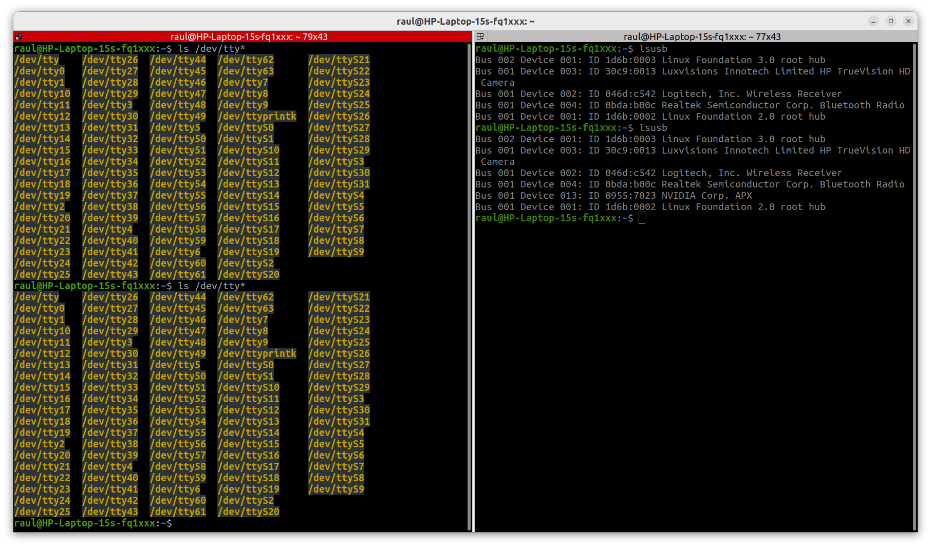

Thank you, I have minicom installed, but I can’t find the /dev/ttyACM* device. When the board is first plugged I can’t find it, but when I put it into recovery mode, I can at least see it with lsusb command, as per the following screenshot:
I’m using the USB-C cable, by the way, the same one I’m using for the flashing process. How can I make the serial port accessible? And after that, what kind of output should I look for?
Thank you.
Do you connect the Micro-USB port as guide mentioned?
Hi, sorry, I was using the USB-C cable, which was also mentioned on the guide. Does it only work with Micro-USB after all?
I will try again with the Micro-USB cable as soon as I can get one. Also, if I can see the device after all, how can I tell what’s the issue during boot? Thank you
USB-C would only work when your system is able to boot.
Micro USB will output log even when your system fails to boot. Hope this clarify your question.
That is why we are waiting for your log. We would check.
