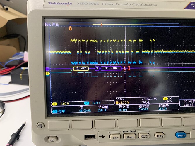

AON-R5-FreeRTOS侧配置CAN0、TX2 Linux侧配置CAN1(ip link set can1 type can bitrate 500000 dbitrate 2000000 fd on)。
总线上只有TX2的CAN0、CAN1时:两侧均显示BUS ERR中断,无法互相接收&发送;
总线上挂载其它设备时:Linux侧的CAN1可以和其它设备正常通信,R5侧的CAN0控制器连续报BUS ERR中断;

使用示波器测量CAN速率是500K,但是波形、帧格式比较奇怪,大部分帧无法识别。
Can you share the waveform? Wrong clock, or bad quality?

From the waveform, I cannot see difference between ‘good’ and ‘bad’ cases. So, I think the basic configurations should be good.
Maybe there’re some other configs which are missed in SPE, like sample point?
You can check the MTTCAN registers and compare the settings in ‘good’ and ‘bad’ case.
