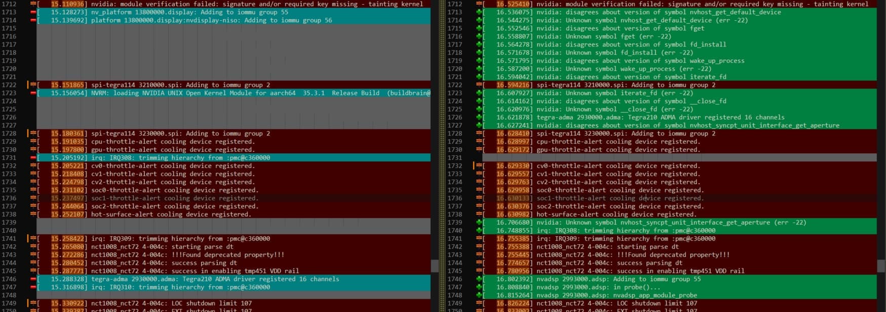

The left one is normal booting with default kernel image
and the right one is no display booting with mroute activated kernel image.
I wanna know messages are what that means in green box.

As I already mentioned, I already checked the log. And your log just indicate nvidia.ko has some symbol which is not recognized.
[   16.355217] nvidia: loading out-of-tree module taints kernel.
[   16.363021] nvidia: module verification failed: signature and/or required key missing - tainting kernel
[   16.375440] nvidia: disagrees about version of symbol nvhost_get_default_device
[   16.383813] nvidia: Unknown symbol nvhost_get_default_device (err -22)
[   16.383867] nvidia: disagrees about version of symbol fget
[   16.383869] nvidia: Unknown symbol fget (err -22)
[   16.383910] nvidia: disagrees about version of symbol fd_install
[   16.383911] nvidia: Unknown symbol fd_install (err -22)
[   16.384007] nvidia: disagrees about version of symbol wake_up_process
[   16.384008] nvidia: Unknown symbol wake_up_process (err -22)
[   16.384082] nvidia: disagrees about version of symbol iterate_fd
[   16.384083] nvidia: Unknown symbol iterate_fd (err -22)
[   16.384156] nvidia: disagrees about version of symbol __close_fd
[   16.384157] nvidia: Unknown symbol __close_fd (err -22)
[   16.384370] nvidia: disagrees about version of symbol nvhost_syncpt_

Did you ever rebuild nvidia.ko/nvidia-modeset.ko with your new kernel and remember to put new modules to /lib/modules?
This issue totally has nothing to do with mroute. It is just you didn’t do the whole steps to update kernel. If you change any thing in kernel, then you need to update all of them (Image/modules)
