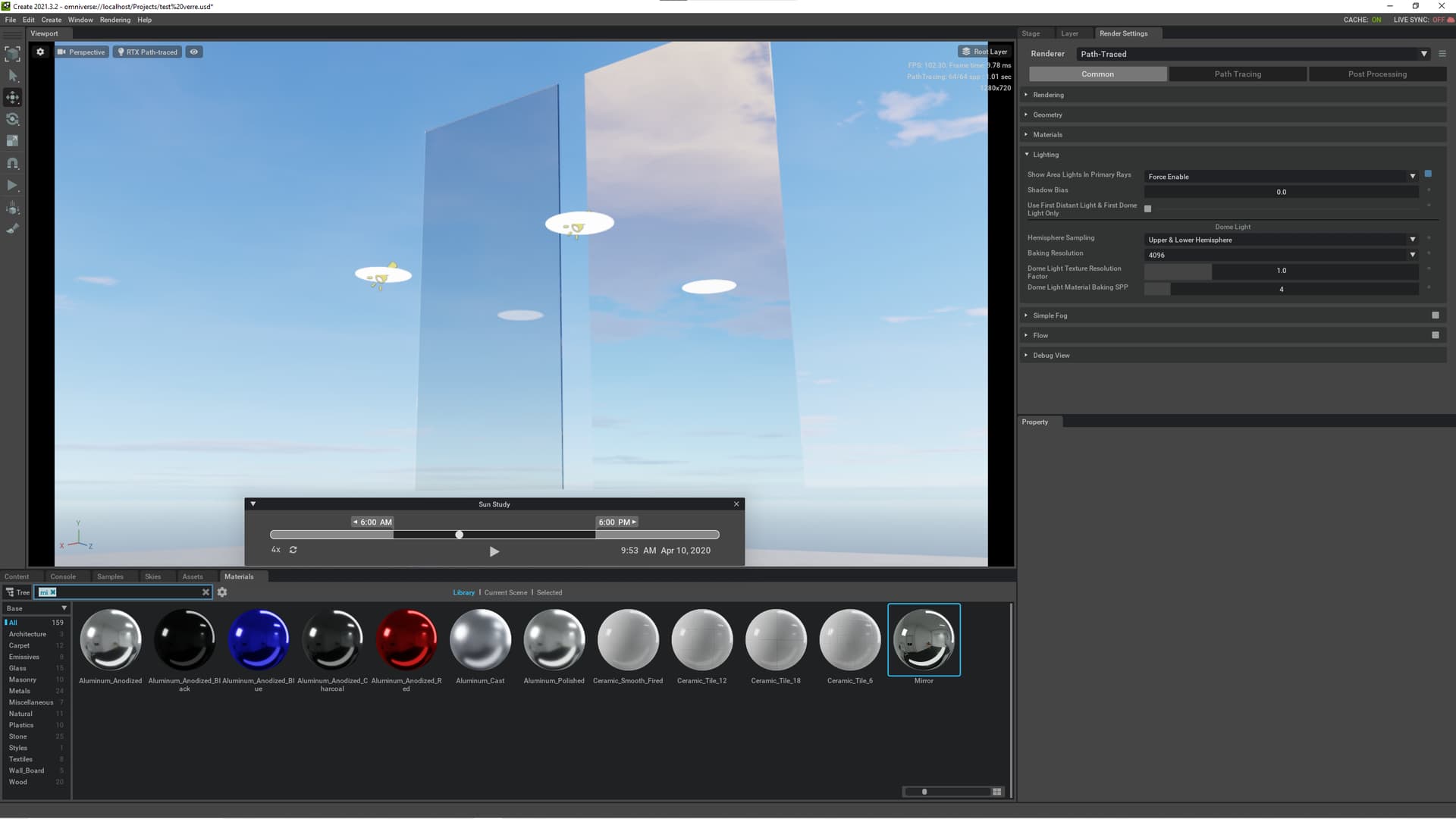

How can I turn off the light source reflection on glass in Iray photoreal mode. It is not there in Path-traced. attached is a markup of the light issue in glass reflection.

From the image I cannot see where the lights are and which type they are:
The render settings have those options:

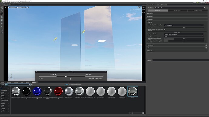

Light Visible in Primary Rays Adds the visibility of lights other than emissive geometry. Options are:
Per-Light Enable : Defined in each light respectively.
Force Enable : Enabled for all lights regardless of light settings.
Force Disable : Disabled for all lights regardless of light settings.
Have you played with those?

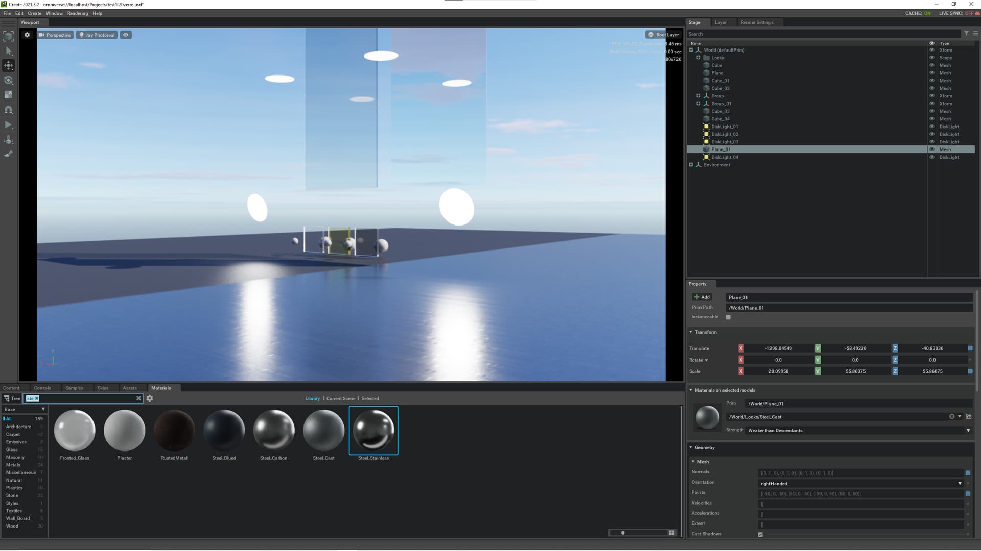

hello,
I don’t understand why you want to remove the reflection because it actually exists.
I did a test with an “Omniglass” element and another in mirror, with two circular lights and the reflection is visible if the point of view of the camera is below the light.
And this one is visible for RTX Rendering; Path tracing and Iray the only difference is that in Iray area light is visible, while for the others you have to play with the parameters that AFUCHS mentioned.

Thanks all for responding. I am using the disk light incorrectly. I was trying to replicate a light bulb or cone light. but as i increase the radius, the reflection in glass also enlarge and it looks funny in image.
In view, I was able to replicate a cone light and it works great. Any suggestion to create a cone shape fixture in create?

Thank for the direction. It is in shaping, light behaves differently in view. will need further study but i did solved the problem with your direction. Will post result soon.
