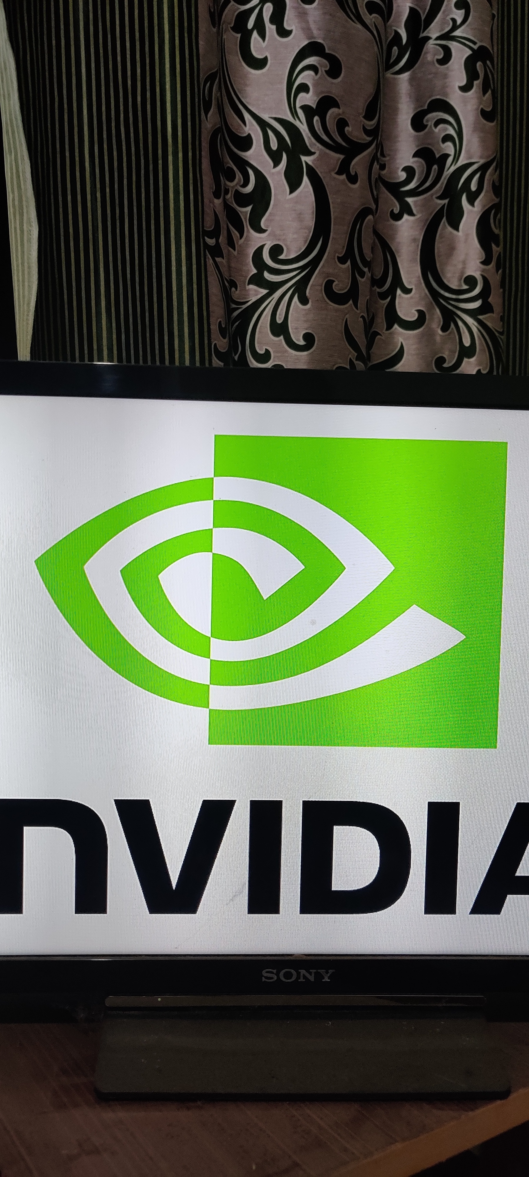

Mouse and keyboard stopped working on Jetson nano
I got my Jetson nano last week . I boot it up using 16gb sd card thn it showed a error message and to report it. That msg showed every time when ever I turn on my system . Yesterday when I tired to install qt creator it stopped working also my SD was almost full so i thought it’s happening because of no memory space . I again tired to boot it up using 64 gb SD card it showed same error msg thn after some time it restarted by itself and after that keyboard and and mouse stopped working . Both lan and HDMI port working fine bt 4 USB port not working .

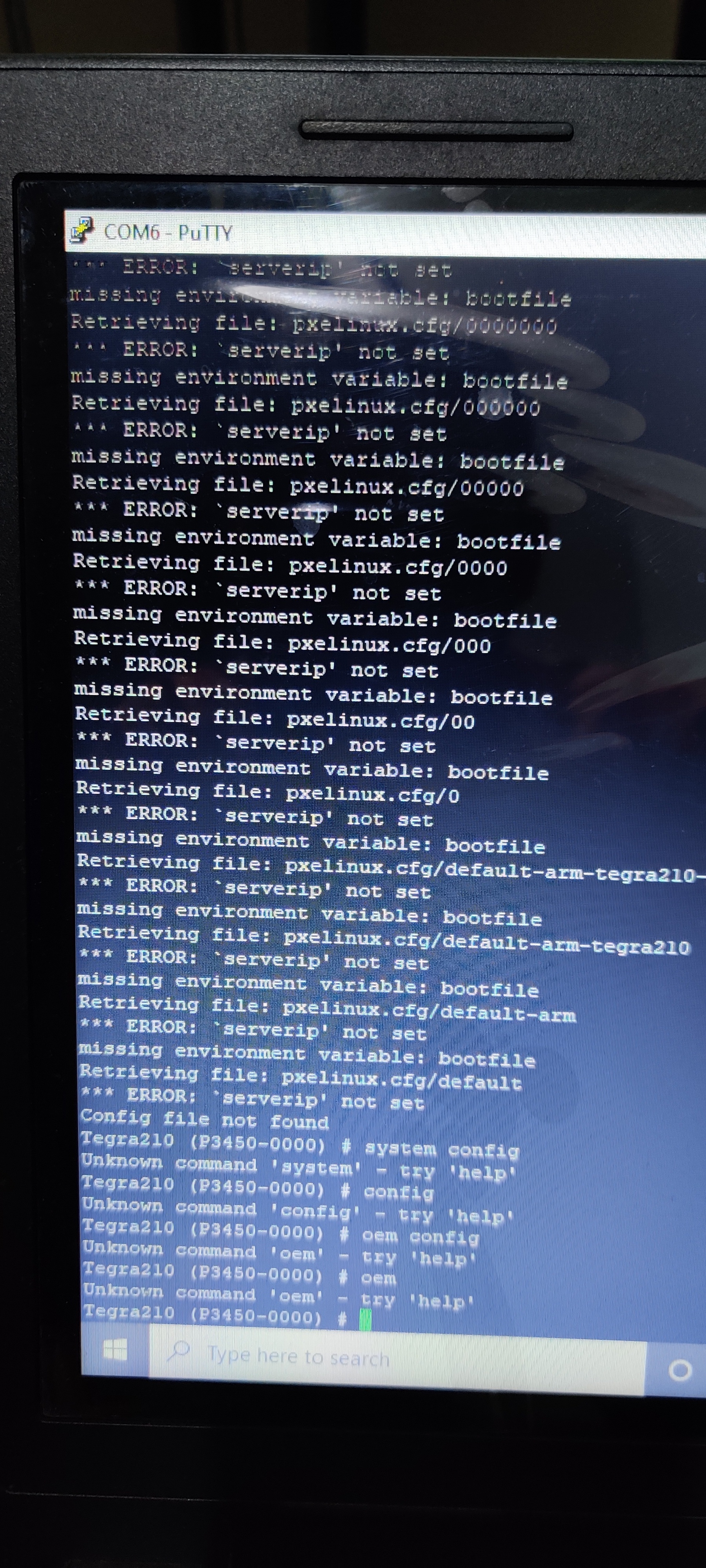

Could you share the dmesg?
sry for late replay,
i try to connect nano to pc over serial using pl2303hx 3.8 drivers and i got these messages
[0000.125] [L4T TegraBoot] (version 00.00.2018.01-l4t-e82258de)
[0000.130] Processing in cold boot mode Bootloader 2
[0000.135] A02 Bootrom Patch rev = 1023
[0000.138] Power-up reason: pmc por
[0000.141] No Battery Present
[0000.144] pmic max77620 reset reason
[0000.147] pmic max77620 NVERC : 0x40
[0000.151] RamCode = 0
[0000.153] Platform has DDR4 type RAM
[0000.156] max77620 disabling SD1 Remote Sense
[0000.161] Setting DDR voltage to 1125mv
[0000.165] Serial Number of Pmic Max77663: 0x817cf
[0000.172] Entering ramdump check
[0000.175] Get RamDumpCarveOut = 0x0
[0000.178] RamDumpCarveOut=0x0, RamDumperFlag=0xe59ff3f8
[0000.184] Last reboot was clean, booting normally!
[0000.188] Sdram initialization is successful
[0000.192] SecureOs Carveout Base=0x00000000ff800000 Size=0x00800000
[0000.198] Lp0 Carveout Base=0x00000000ff780000 Size=0x00001000
[0000.204] BpmpFw Carveout Base=0x00000000ff700000 Size=0x00080000
[0000.210] GSC1 Carveout Base=0x00000000ff600000 Size=0x00100000
[0000.216] GSC2 Carveout Base=0x00000000ff500000 Size=0x00100000
[0000.222] GSC4 Carveout Base=0x00000000ff400000 Size=0x00100000
[0000.228] GSC5 Carveout Base=0x00000000ff300000 Size=0x00100000
[0000.233] GSC3 Carveout Base=0x000000017f300000 Size=0x00d00000

[ 14.051294] Please complete system configuration setup on the serial port provided by Jetson’s USB device mode connection. e.g. /dev/ttyACMx where x can 0, 1, 2 etc.
Please use oem config from your host to configure the user account, let it boot into desktop and then use serial console to access the board and dump dmesg.
[Uploading: 16146173194771193442762861692979.jpg…](
I am not able to proceed any further and feeling helpless now. If you are available anytime can we sync up over any online meeting platform so that it will be convenient for both of us to resolve this issue.
I will be very grateful if you help me through this.
  1. If you want to share any log, share it as a text file with full log. Photo or screenshot do not reveal the full log and no one could tell what is going on.
  2. What did you do to cause this? You were able to boot into kernel but now it does not.
Yes I can’t boot to kernel it’s happen by itself,when I tired to install qt creator
Strange…apparently it didn’t find a boot device and is falling back to trying to network boot. If your boot media is missing (for any reason), then I’d expect this.
Your story and your comment are not matching to your log.
In your first log, the last line says
“[ 14.051294] Please complete system configuration setup on the serial port provided by Jetson’s USB device mode connection. e.g. /dev/ttyACMx where x can 0, 1, 2 etc.”
This line only appears in your first boot up after flash. This means it is not possible to install anything like qt to your system unless you finish the configuration.
And now you say “Yes I can’t boot to kernel it’s happen by itself,when I tired to install qt creator”. But it is totally impossible to install Qt as system configuration is not finished. How could you install anything to system when system is not ready?
So either the log lies or you didn’t tell the whole story here. If you cannot tell the story well, please at least share the full boot up log as text file here.

Ok, then could you share the full log as text file for your 16GB card?
My first log was 64gb and it’s not configured and 2nd post 16gb and it’s configured . I’m trying over both to reach kernel so that I can post dmesg .
I am not asking the dmesg now. You already dumped the boot up log well for your 64gb card from “nano to pc over serial using pl2303hx”
Now what I need to check if same log from your 16gb card. There is no way and no sense to dump a kernel log if kernel is not up at this moment.
this one from my 16gb sd card…

BOOTP broadcast 1
BOOTP broadcast 2
BOOTP broadcast 3
BOOTP broadcast 4
BOOTP broadcast 5
BOOTP broadcast 6
BOOTP broadcast 7
BOOTP broadcast 8
BOOTP broadcast 9
BOOTP broadcast 10
BOOTP broadcast 11
BOOTP broadcast 12
BOOTP broadcast 13
BOOTP broadcast 14
BOOTP broadcast 15
BOOTP broadcast 16
BOOTP broadcast 17
Retry time exceeded; starting again
Tegra210 (P3450-0000) # BOOTP broadcast 14
Unknown command ‘BOOTP’ - try ‘help’
Tegra210 (P3450-0000) # BOOTP broadcast 15
Tegra210 (P3450-0000) # BOOTP broadcast 16oadcast 17
Tegra210 (P3450-0000) # Retry teuuid
Unknown command ‘Retry’ - try ‘help’
Tegra210 (P3450-0000) # missing environment varble: bootfile
Unknown command ‘missing’ - try ‘help’
Tegra210 (P3450-0000) # not set
Unknown command ‘not’ - try ‘help’
Tegra210 (P3450-0000) # missing environment variable:rverip’ ile: pxelinux.cfg/000000
*** ERROR: serverip' not set Unknown command 'missing' - try 'help' Tegra210 (P3450-0000) # missingnt variable: bootfile Unknown command 'missingnt' - try 'help' Tegra210 (P3450-0000) # Retrieviset Unknown command 'Retrieviset' - try 'help' Tegra210 (P3450-0000) # missing environment variaverip' not s.cfg/000 *** ERROR: serverip’ not set
Tegra210 (P3450-0000) # missingment variable: bootfile
Unknown command ‘missingment’ - try ‘help’
Unknown command ‘Retrie’ - try ‘help’
Tegra210 (P3450-0000) # missing environment variable: set
Tegra210 (P3450-0000) # miscfg/default-arm-tegra210-p3450-000bootfile
Unknown command ‘miscfg/default-arm-tegra210-p3450-000bootfile’ - try ‘help’
Tegra210 (P3450-0000) # Retrieving file: pxelinux.cfg/default pxelinux.cfg/default-arm
Unknown command ‘Retrieving’ - try ‘help’
Tegra210 (P3450-0000) # *** ERROR: serverip' not set missingault *** ERROR: serverip’ notonfig file not found
Unknown command ‘***’ - try ‘help’
Tegra210 (P3450-0000) # BOOTP broadcast 2
Tegra210 (P3450-0000) # BTP broadcast 6
Unknown command ‘BTP’ - try ‘help’
Tegra210 (P3450-0000) # BOOdcast 10
Unknown command ‘BOOdcast’ - try ‘help’
Tegra210 (P3450-0000) # BOOTP brost 14
Tegra210 (P3450-0000) # BOOTP broaexceeded; st 3
Unknown command ‘st’ - try ‘help’
Tegra210 (P3450-0000) # BOOTP broadcOOTP broadcast 8
Tegra210 (P3450-0000) # BOOTP broadcast 15starting again
The term “full log” means you should dump the log at the moment the board is restarting…
this one

Hit any key to stop autoboot: 0
switch to partitions #0, OK
mmc1 is current device
Scanning mmc 1:1…
** Unable to read file / **
Card did not respond to voltage select!
starting USB…
Bus usb@7d000000: tegrausb: Invalid dr_mode 2 for host mode
probe failed, error -1
Bus xusb@70090000:
Firmware size 124416
Firmware timestamp: 0x5da88fc3, Version: 50.25 release
Register HCSParams1: 9000124 NbrPorts: 9
Starting the controller
USB XHCI 1.00
scanning bus xusb@70090000 for devices… 1 USB Device(s) found
scanning usb for storage devices… 0 Storage Device(s) found
Device 0: unknown device
Warning: eth_rtl8169 using MAC address from ROM
BOOTP broadcast 1
BOOTP broadcast 2
BOOTP broadcast 3
BOOTP broadcast 4
BOOTP broadcast 5
BOOTP broadcast 6
BOOTP broadcast 7
BOOTP broadcast 8
BOOTP broadcast 9
BOOTP broadcast 10
BOOTP broadcast 11
BOOTP broadcast 12
BOOTP broadcast 13
BOOTP broadcast 14
BOOTP broadcast 15
BOOTP broadcast 16
BOOTP broadcast 17
missing environment variable: pxeuuid
missing environment variable: bootfile
Retrieving file: pxelinux.cfg/01-00-04-4b-ec-b1-32
*** ERROR: serverip' not set missing environment variable: bootfile Retrieving file: pxelinux.cfg/00000000 *** ERROR: serverip’ not set
*** ERROR: serverip' not set missing environment variable: bootfile Retrieving file: pxelinux.cfg/000000 *** ERROR: serverip’ not set
*** ERROR: serverip' not set missing environment variable: bootfile Retrieving file: pxelinux.cfg/0000 *** ERROR: serverip’ not set
*** ERROR: serverip' not set missing environment variable: bootfile Retrieving file: pxelinux.cfg/00 *** ERROR: serverip’ not set
*** ERROR: serverip' not set missing environment variable: bootfile Retrieving file: pxelinux.cfg/default-arm-tegra210-p3450-0000 *** ERROR: serverip’ not set
*** ERROR: serverip' not set missing environment variable: bootfile Retrieving file: pxelinux.cfg/default-arm *** ERROR: serverip’ not set
*** ERROR: `serverip’ not set
Config file not found
BOOTP broadcast 1
BOOTP broadcast 2
BOOTP broadcast 3
BOOTP broadcast 4
BOOTP broadcast 5
BOOTP broadcast 6
BOOTP broadcast 7
BOOTP broadcast 8
BOOTP broadcast 9
BOOTP broadcast 10
BOOTP broadcast 11
BOOTP broadcast 12
BOOTP broadcast 13
BOOTP broadcast 14
BOOTP broadcast 15
BOOTP broadcast 16
BOOTP broadcast 17
BOOTP broadcast 1
BOOTP broadcast 2
BOOTP broadcast 3
BOOTP broadcast 4
BOOTP broadcast 5
BOOTP broadcast 6
BOOTP broadcast 7
BOOTP broadcast 8
BOOTP broadcast 9
BOOTP broadcast 10
BOOTP broadcast 11
BOOTP broadcast 12
BOOTP broadcast 13
BOOTP broadcast 14
BOOTP broadcast 15
BOOTP broadcast 16
BOOTP broadcast 17
Scanning mmc 1:1…
Uboot is not able to read sdcard. Could you format your sdcard and reinstall the image again to see if uboot can read it now?
Just let you know, currently there are two issues here. We deal with the 16gb card issue first and then the usb.
For the usb, you may need to use sdkmanager to debug. Thus, need to prepare a x86 host for either ubuntu 16.04 or 18.04.
I have Ubuntu 18.4 and sdk manager . What to do after that?
