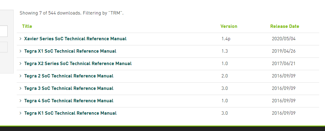

You can down the TRM from download center. Jetson Download Center | NVIDIA Developer
