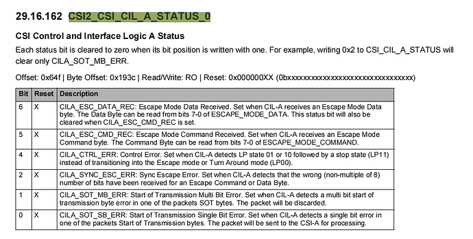

Looks like signal problem. Have check the REG CSIx_CSI_CILA_STATUS_0 from TRM to get more information.
CILA_CTRL_ERR: Control Error. Set when CIL-A detects LP state 01 or 10 followed by a stop state (LP11)
instead of transitioning into the Escape mode or Turn Around mode (LP00).

TRM can download from download center. Tegra X1 SoC Technical Reference Manual
ShaneCCC:
vi 54080000.vi: TEGRA_CSI_CILX_STATUS 0x00040040
0x00040040 == 0b0100 0000 0000 0100 0000
This message shows that Bit 6 and Bit 18 is set to 1 .
What should I do next?
[ 113.837690] vi 54080000.vi: TEGRA_CSI_CIL_STATUS 0x00000010
0x00000010 == 0b00010000
This message shows that Bit 4 is set to 1 . means CILA_CTRL_ERR
[ 113.837737] vi 54080000.vi: TEGRA_CSI_CILX_STATUS 0x00040040
This message shows CILA_DATA_LANE1_CTRL_ERR and CILA_DATA_LANE0_CTRL_ERR
Hi Shane
Is there any way to check whether the MIPI data of MAX9296 is normally transmitted to the CSI interface of nano?
Sorry, may need to check with scope to make sure the signal.
