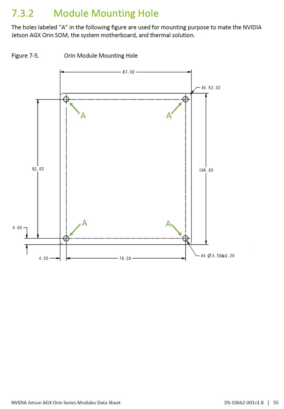

On page 6 of the thermal guide, Table 2-2 indicates that the maximum TTP operating temperature is 85°C and also indicates that the recommended SoC operating temperature is 105°C and the maximum SoC operating temperature is 115°C. I presume that if the TTP is at 85°C, that the SoC will be at 105°C, but this is unclear.
On page13 of the thermal guide, Figure 3-4 shows the hole locations in the TTP (79.00 x 92.00mm). What is the tolerance on these dimensions? Also, what is the hole diameter and tolerance?
On page 15 of the thermal guide, point 5 of the assembly guidelines indicates that the M3 screws should be “fully torqued”. What is the recommended torque?

For tolerance and dimension please refer to the 3D CAD model Jetson AGX Orin Series Module 3D CAD STEP model (P3701) https://developer.nvidia.com/downloads/jetson-agx-orin-module-3d-step-modelzip
I have the 3D model and tolerance information is not available in the 3D model, therefore it needs to be communicated by some other means. Please provide the location tolerance of the holes and also the tolerance of the hole diameter.
Thank you

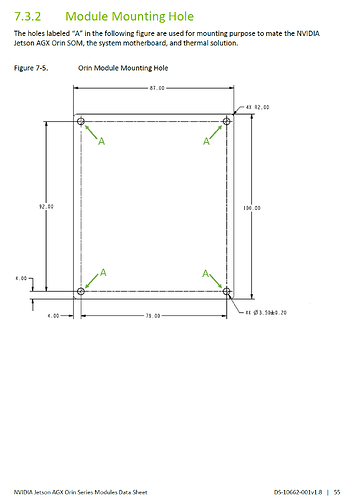

Please refer to the Mechanical Specifications in the AGX Orin data sheet. Jetson AGX Orin Series Data Sheet (Including AGX Orin Industrial) Log in | NVIDIA Developer
Thanks again for your reply – this drawing does have the hole diameter tolerance, but not the location tolerance.
