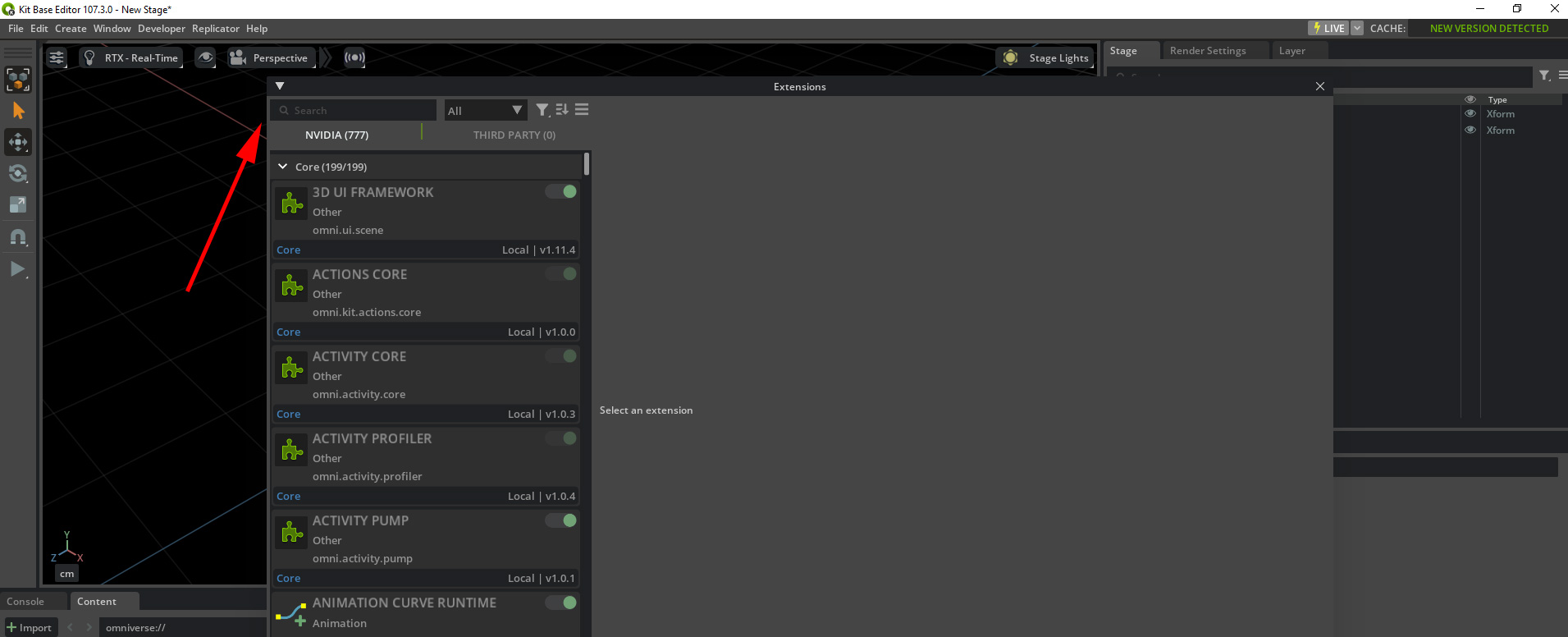

According to documentation https://docs.omniverse.nvidia.com/kit/docs/kit-manual/latest/guide/extensions_basic.html, for creating a new extension, under extensions window it should show the “add” button with a +. I am using the kit sdk 107.3 and that button is missing in the extensions window
Main Issue:
Extensions windows does not show the add button “+”
Reproduction Steps:
Open extensions window. The “+” should be there left to the find box
Error Code: No error code
@dt_developer as another user, it looks like the documentation in the provided link is quite dated. i cannot recall what that + icon does since the button has been removed in UI updates few kit versions ago. are you looking to import or create an extension? if the former, you can find Import Extension option under the hamburger icon.

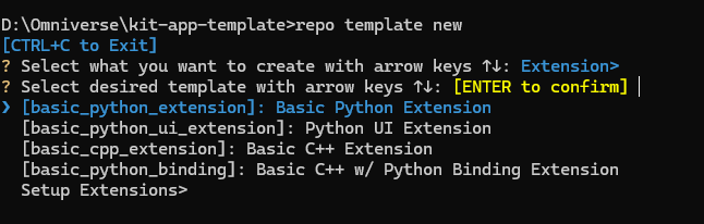

To build a brand new extension you now use the Kit App Template command “repo.bat template new” and then pick to create an extension not an application. Then this will create the basic framework for your extension that you can import.
Thanks @Richard3D, I have created a new template with that method and I am developing it now.
