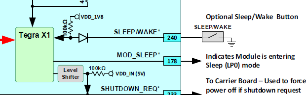

I think I don’t need to change the pinmux as I tried to follow the schematics of the carrier board. The thing is I am a bit lost with the pins voltage that should be applied on each system pin to power on the jetson nano. For example, the excel jetson nano pin description shows a 5V CMOS pullup for the sleep/wake* pin :

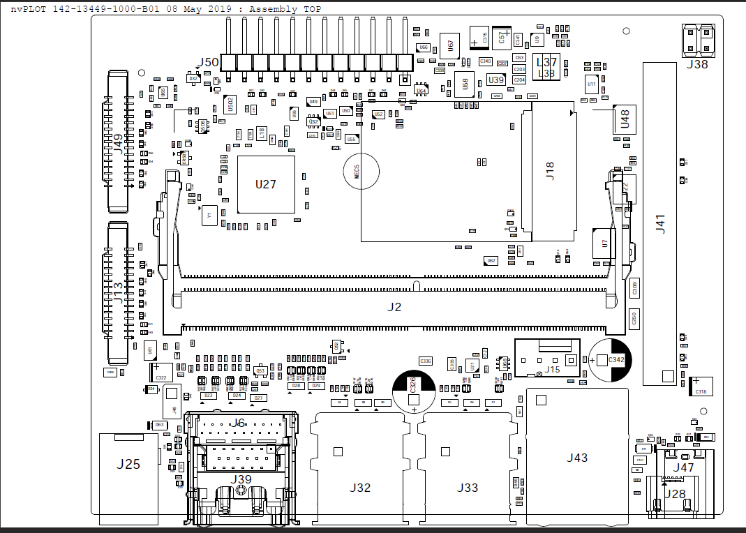

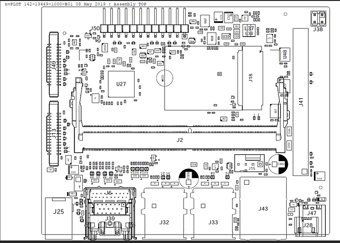

My carrier board is referenced p3450 on its bottom side, but I can’t find its information in the jetson download center. For example my carrier board does not include the J50 connector shown in the above picture.
Is it possible to access the resources regarding my version of the carrier board please ?
