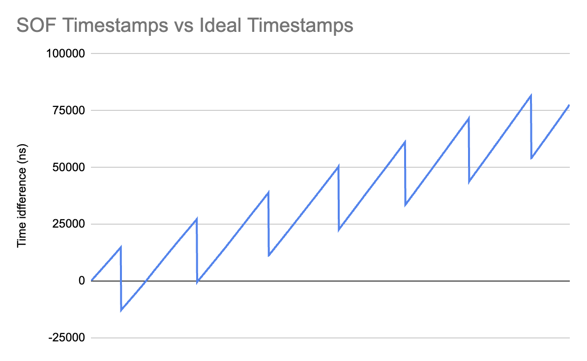

I am experimenting with fsync-groups with the TSC generator and NVPPS and while I am getting encouraging results, the most important part seems to not be working as implied by the Orin Timesync document. Specifically:
- I enabled fsync-groups in the dtsi, changing from status=“disabled” to status=“okay”
- I have an external PTP master connected to J11 Port 4, and ptp4l is running on mgbe2_0 and shows a valid synchronization
- I use ioctl to poke nvpps (timer mode, results in nanoseconds) to get the both tsc and ptp timestamps of the last event, both are showing reasonable values
- I use the offset value from the ptp timestamp to the tsc timestamp, modulo 1 second, converted down to tsc ticks and use nvsipl_camera with the -F flag (fsync-groups), specifying group 0 and the tsc tick count of the desired time of start triggering (plus something like 2 seconds to let it initialize first)
- I am probing the output of the camera trigger and comparing it to the PPS output of my PTP grandmaster
I would expect based on the documentation that I have effectively told it ‘start at the TSC equivalent of the PTP second’, and I would expect that the rising edge of the trigger would concide with the PPS output of the grandmaster plus or minus the lock-in value (by default 20us) of the TSC to PTP synchronization system.
Instead, I see the rising edges start nearly perfectly aligned every time (off by about 2 microseconds), and then the fsync pulse starts moving backwards relative to grandmaster PPS output, sliding continuously at the rate of a few microseconds per second, until it’s well over 20 microseconds.
This tells me that whatever mechanism is aligning TSC and PTP is not working accurately. I can verify (1) that the ptp4l instance is working correctly and that I am timesync’d to the external grandmaster, (2), dmesg tells me that it is getting lock state updates, and while it does say that it can’t get concurrent timestamps from mgbe2_0, it appears that it is in fact working correctly (I suspect that is when I was starting ptp4l on mgbe2_0, and (3) the fsync groups are working as expected, though I note that I have to rmmod and modprobe cam_fsync every time as nvsipl_camera doesn’t appear to cleanly disable cam_fsync after it quits. Here’s the dmesg output for nvpps:

Can you please help me out to figure out why PPS to TSC syntonization isn’t working as described in the documentation?
