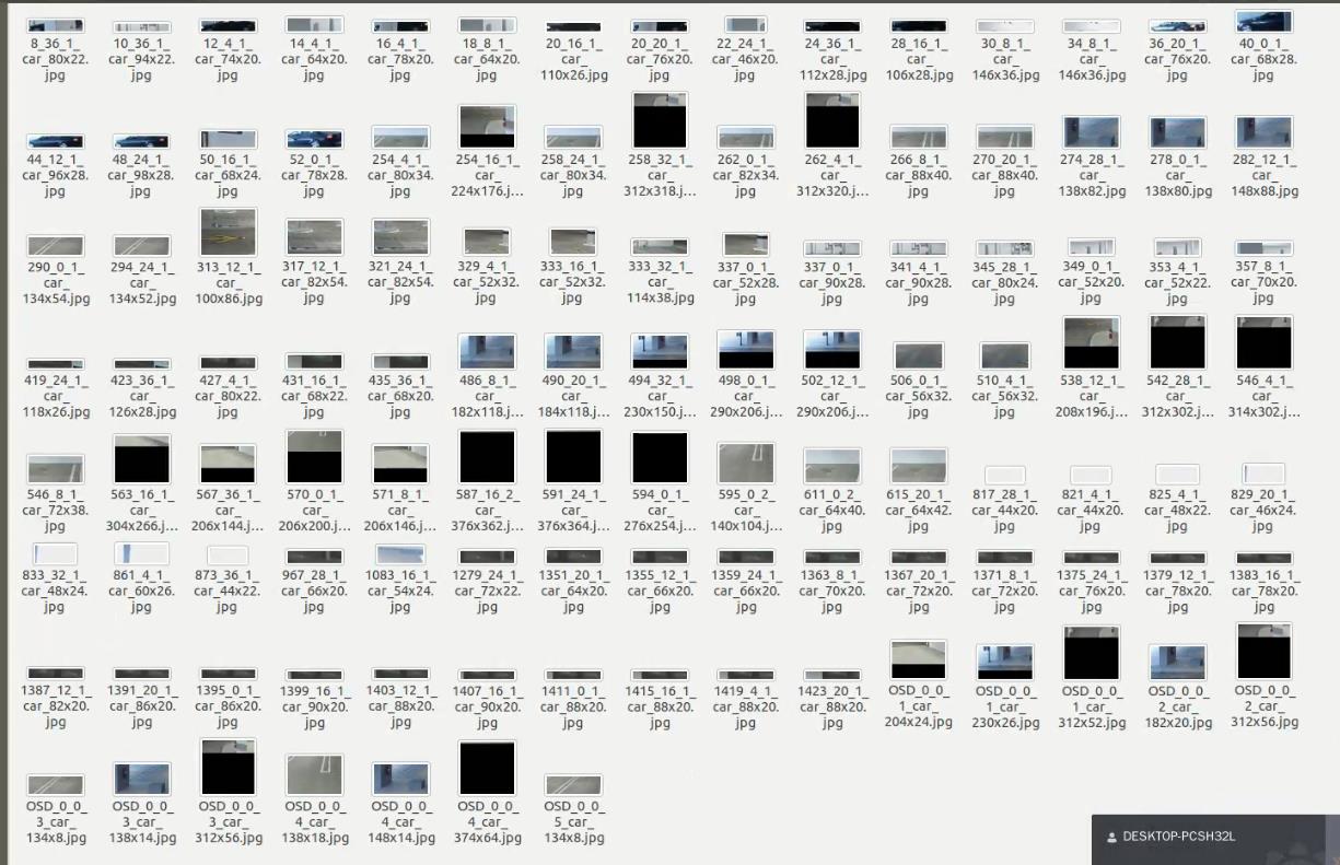

when i run deepstream-transfer-learning-app with multi sources so i get file name of image does not match the image.
the out put like

i has solve this problem by set nvinfer batch-size different streammux batch

I have 4 input videos ( all batch-size=1), I set steammux batch-size=4, and primary-gie batch-size=8, but the save image name is still wrong

I also found the mismatching of ‘source_id’ and ‘batch_id’, I solved this by change the frame_meta befor save image.
NvDsFrameMeta *f_meta = (NvDsFrameMeta*) g_list_nth(batch_meta->frame_meta_list, source_id)->data;
