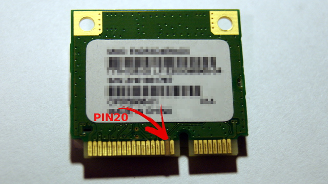

Since (for now) Jetson TK1 does not correctly support rfkill for wifi card, we can try to hack hardware.
Tested with .
- mask pin 20 on bottom side wifi card
![](https://global.discourse-cdn.com/nvidia/original/3X/a/5/a5b71fa467ad7287d0b75cd2f41127d893803d28.jpeg)

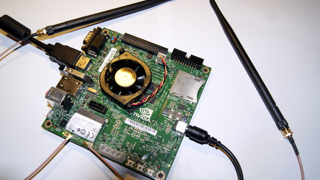

- compile kernel with required modules and add firmware (if required)
Guide: [HowTo] Build own kernel for Jetson TK1 - Jetson TK1 - NVIDIA Developer Forums

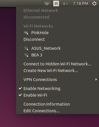

- well done :) wifi is working
![](https://global.discourse-cdn.com/nvidia/original/3X/1/b/1b8a49adb3f252ff33d3b2a0631f84ebe405e64d.jpeg)
![](https://global.discourse-cdn.com/nvidia/original/3X/5/b/5b9268ffb3db8177899c88112164cbc4be5d6759.png)
- Tested wifi cards:
Working adapters with mask pin 20:
Not working adapters with mask pin 20:
Intel Centrino Wireless-N 2230 - something wrong with my adapter or bug in kernel
