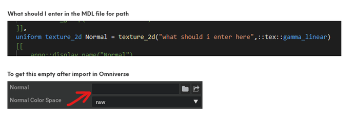

I need help in creating MDL materials with OmniUE4.
I want to know what should I enter in the Path of a Texture if I want it to be left empty after import in Omniverse Create?

You can change to this: uniform texture_2d Normal = texture_2d()
thanks a lot for the help!!!
