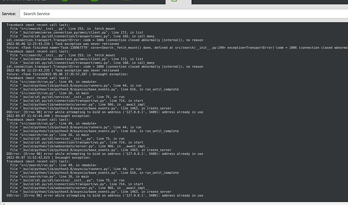

Omniverse auth-service fail, can not login local nucleus
This is a common problem that occurs frequently on my machine 。
I can not login the nucleus from localhost:8080 , but it show all apps run normally from localhost:3080
the auth service seems working normally
so I cannot connect to local nuclues server because of auth, also I can not use nucleus’s models in isaacsim, the model file allow read only but not write
and here is the log of auth and nucleus:
there is a error in search service, but I kill the process of search service , and the port is not in use; and I start search service ,but it does not work
I have solved it by updating the nucleus to 2022.1.2 !!! Thanks
