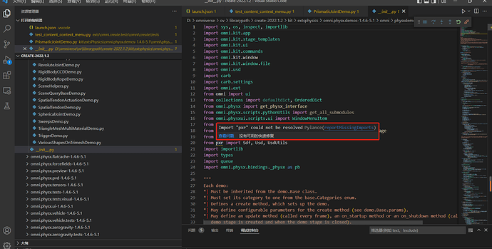

Using launch.json configuration to show a connection failure, is there something wrong with my configuration? What are the functions of pathMapping and runtimeArgs in your JSON file?Should I set my own working path address behind the WorksapceFolder?
“remoteRoot”: “${workspaceFolder}”,
“localRoot”: “${workspaceRoot}”,
I don’t know what to put in the path here? Like the kit.exe path to create

According to your configuration, I cannot import PXR and access its source code

This json has smth wrong in it, as it is possible to connect to the CREATE from VS Code, but debugger catches no breakpoints. I use VS Code 1.79.1. Probably VS Code, or some plugin that knows about python debugging, prepares json in a wrong way.
A json that mati-nvidia has posted is the one that brought back my debugger to the proper work.
