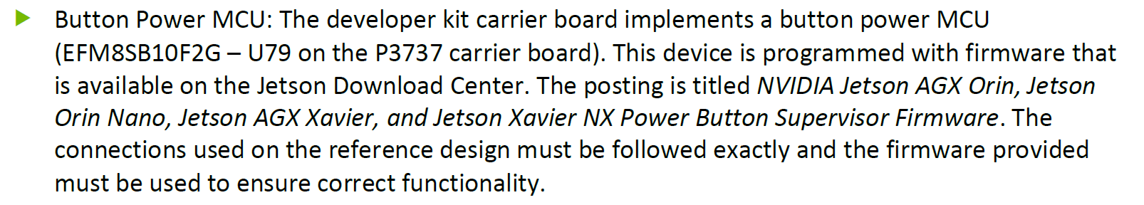

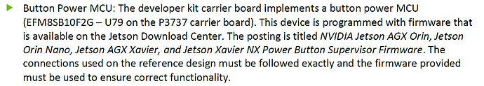

Also, refer to Button Power MCU section in Chapter 4. Reference Design Considerations in Jetson AGX Orin Series Design Guide (including AGX Orin Industrial) available through search Jetson Download Center | NVIDIA Developer
Thanks sgursal.
I looked at the Button Power MCU section in Chapter 4. Reference Design Considerations. It does not refer to the UARTs between the SOM and the MCU at all…
Also, I’m looking for the code for U136 on the P3737_A05 schematics (U136 is the ATSAMD21G16B-AU_P3737).
Please advise…
