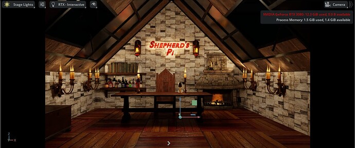

Uploaded is a screen shot of my scene. Everything in this scene is status with the exception of the glass of wine on the table. It was supposed to be a glass mug of Beer with a head on it, but although entire factories and automobiles can be created in this app… a beer impossible. So white wine is it… the script writers with have to adjust. When the character is added the glass of wine will be the only thing at this point he will pick up and move. Nothing Else!
I was also suppose to be a dark and stormy night, needless to say I gave up on that also.
I turned of the Candle Flame Emitters while working, I mean waiting my time for weeks on the beer, er now wine… and just turned them all back on.
With the Stage Lights on… it took 50 minutes to render the viewport… which by the way, is the longer the app has run with locking up or crashing my computer.
It finished, or I think it did, but my beer, uh sorry, white wine is black, and then is locked up.
So according to Reallusion I am supposed to connect live to this and drop my character in while I capture his animation in IClone 8 and Record it in Onmiverse… I really don’t see that happen unless someone there can help set this so that it will perform better.
Oh yes, I still have a laptop to add to his table, no physx, and an Hour Glass ( I was planning on physx) and the character himself has a halo that will in some sparks… (phyisx)…

Ok some thoughts.
  1. You want this to be in the RTX Realtime, not RTX Pathtracing. If you want to connect live and do things “live” then you need to be in “realtime”, hence the name. The lighting is not quite exactly the same, but you can achieve this look easily in realtime with some tweaks. Path tracing is our “offline” renderer.
  2. A single 3080 (laptop version) is not a bad gpu, but it is not our highest performance GPU. If you are looking for more performance, you would need a workstation with more gpu power. However a simple scene like this should be rendering in 50 seconds max, not 50 minutes. How many passes? What resolution ? 50 minutes for an 8k rendering at 10000 passes does seem possible. But for 100 passes at 2k, this should be 30 seconds max.
  3. As you have mentioned, this kind of scene and workflow is not our primary focus. We can do creative scenes like this, but I would have to take a look at your file.
  4. You need to separate the static scene performance issues, from the physics and then we can get a clearer understanding. I would remove ALL physics and all animation and focus on getting the scene correctly lit and rendering at 60fps in realtime mode.
If you send me the scene, I am happy to take a look and see what is causing it to render so slowly. The best way to send me the entire scene with everything is to “collect” it. To do that, go to File > Collect and it will make a whole new folder with everything in it. Zip that folder up and post the link here. You can use online file sharing like dropbox, onedrive, wetransfer etc.

Ok I have managed to open the raw USD file even without materials. Just opening the scene and putting into 1080p resolution in realtime mode, on a single 3090 I am getting 30fps when rendering and 110fps when eco mode kicks in. When I play the animation it drops to 14fps
Scene breakdown:
  1. you have made every flame on the candles a flow emitter with its own flow simulation. That takes a lot of GPU and CPU power. If I turn FLOW off it goes up to 20fps when playing
  2. if I delete the physics sims as well as turning off FLOW, fps jumps to 60fps !
  3. in your environment lighting you have BOTH a domelight on and the skysphere on. You really pick one or the other by default, not both. If you keep the domelight on and turn off the skysphere again the frame rate doubles. I would keep it off.
  4. having reflections on in realtime costs you about 26 fps
  5. having translucency on in realtime costs you about 18fps
  6. materials is costing you about 25fps
  7. you are using a lot of translucent objects. That is really going to slow it down
  8. you are using both illumination from the FLOW objects and also manual normal lights. So you are doubling down there.
  9. you could get away with just ONE light per candle trio, rather than using all three.
There is a lot more to go through but this gives you a start. Like any renderer, you have to know how to tweak and optimize it. More of this, less of this.

Of course if I remove all of the particle physx it will run much better… but that is not the point. The bottles on the shelf are glass and have clear fluid… but since these are static they are not particle physx… but the are translucent.
I will check on the sky vrs dome.
I did go through and merge most of the duplicate meshes, there are a few more to go, and duplicate materials.
I wondered at the time if the 26 candle flame emitters could also be merged? Since they are not Static Meshes I could not find a way to merge them. All of them were created from the WispyFire Preset. Originally, I was hoping to get enough light from the candles without having bonfire over each candle, but I could not figure out the combination of the all those settings to emit more light with lower flame. Without enough light, I had to add an actual light to light the scene, even though demo video said that in RTX-Interactive I would get flame light and glow… I never did.
I believe the illumination you are taking about is the candle wax and the red tip of the wick. the candles could not be seen at all without their illumination. The wick glow was originally limited to the table candles (since most camera shot will be up there on the character sitting) but when I merged meshes, it made them all the same.
So… If you can tell me or direct me to instruction on how to…
(1) merge 26 candle flames into 1 emmitter
(2) how to get more light from the flame without increase it’s size so I can remove 25 light bulbs.
I can to that before sending you the collect USD.
Tuck
Well for 2) You can turn off ALL lights in the scene and then set the AE exposure to about 2000 and you can light the scene really nicely with just the candle flames. It renders slow and needs a lot of render passes but it looks amazing !! Once you send me the usd scene in full, I can show you.
