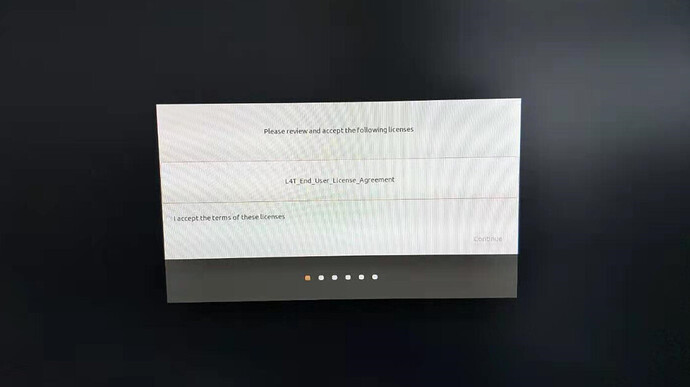

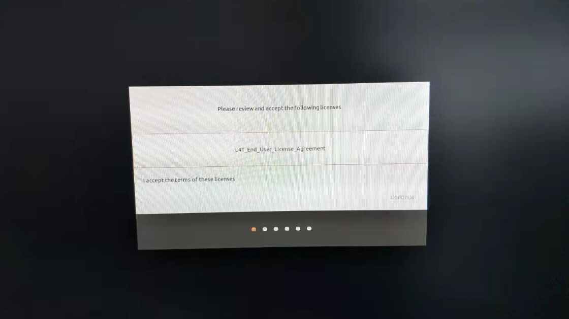

After the system starts
The screen is black,The system cannot start
