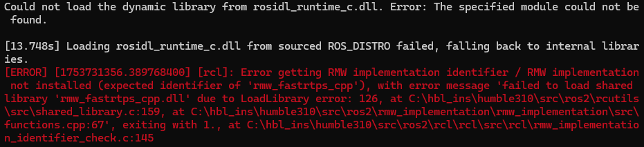

I will try 5.0 to see. But isn’t the PIP install the only current way to download 5.0? If that is the case then I had issues with the 4.5 PIP install which would also not connect to ros2. When i would enter the following then run Isaac Sim i would get the error pictured.
set RMW_IMPLEMENTATION=rmw_fastrtps_cpp
set PATH=%PATH%;C:/env_isaaclab/lib/site-packages/isaacsim/exts/isaacsim.ros2.bridge/humble/lib
