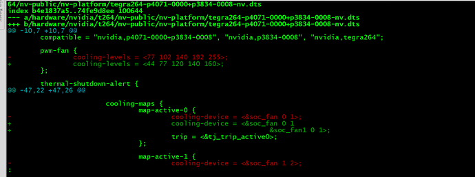

When the machine was turned on, the pwn of the fan was set too high, and the fan made too much noise. The customer requested that it be reduced. Where can the pwm duty cycle be configured

Only when the device is turned on is the sound very loud. After reaching kenel, this sound can be accepted
Could you help to clarify the issue happen in which boot stage? (MB1, MB2, UEFI, Kernel?)
You can simply monitor the noise and check the serial console log at the same time.
hi:
MB1, MB2, UEFI, All three stages are present,do you know how to modify the duty cycle of pwm in the mb1 stage? I can give it a try
Please try to configure the following part in tegra264-mb1-bct-pmic-p3834-xxxx-p4071-xxxx.dtsi for this use case.
