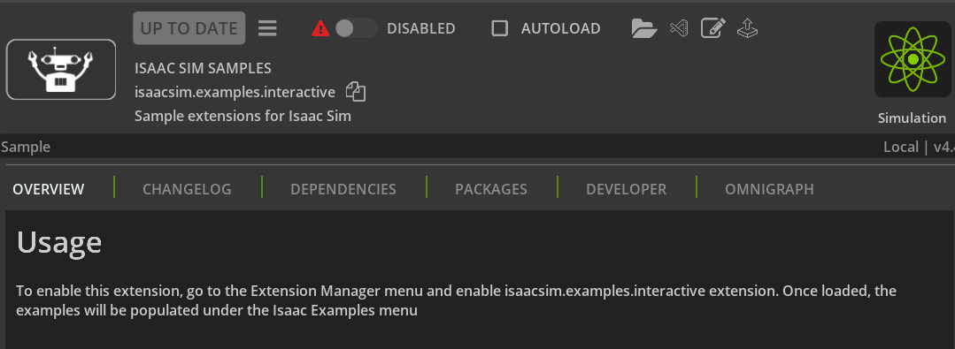

I am unable to view and interact with the robot examples as they’ve seemed to have disappeared. This is what I see when I try to enable it in the extensions window.

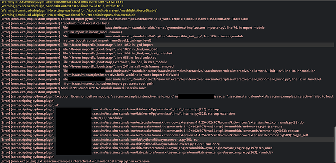

And the console gives me the following error:
[Error] [omni.ext.plugin] [ext: isaacsim.examples.interactive-4.4.8] Failed to startup python extension.

would you be able to provide the full console log as well by chance?
This is what I see when I try to activate the Samples extension:
I got this sorted. There was an error in the example code I was playing with, where I type “sore” instead of “core” while importing a library, and that caused the Samples extension to malfunction.
