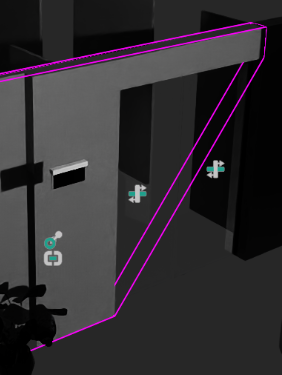

The H1’s fingers clipped into the wall. When i contract the elbow back out of the wall, it pulls the robot in instead.
The wall has a Collider (SDF Mesh) but no RigidBody
Screenshots or Videos
Hi @MrOCW, thanks for posting your question. Is it possible for you to use a Convex Hull or other Collider approximations instead of SDF? My guess is that the SDF is not being computed correctly.

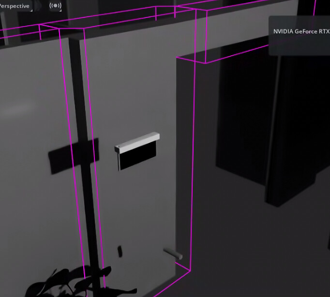

Convex Hull works but the collider does not match the shape of the mesh
That surface looks like a block which should be well approximated by a Convex Hull. Can you show me how it doesn’t match?
@michalin
Can you try to set the collider approximation as Convex Decomposition?
no good
