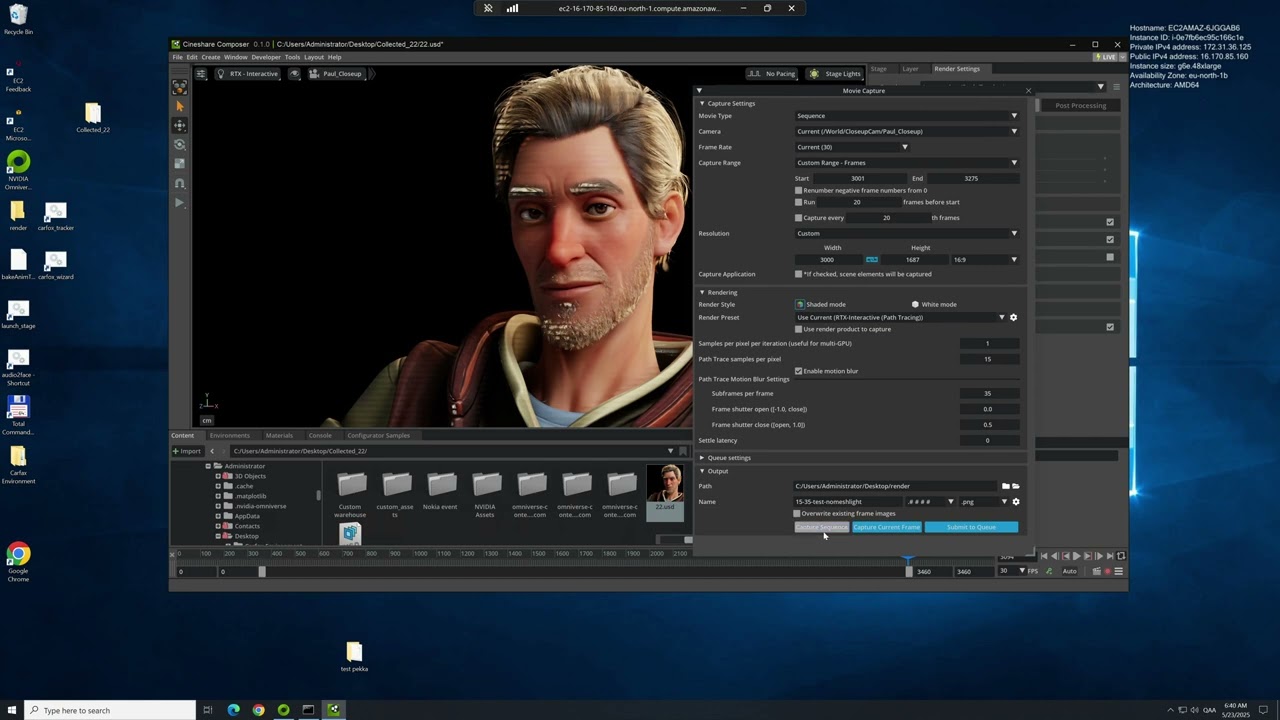

Hello!
This is a continue for the topic Installing kit 106 to 8 gpu L40S aws ok but does not launch - #24 by Richard3D
I have now managed to boot Kit 106 on our Stockholm -region VM with the above specs.

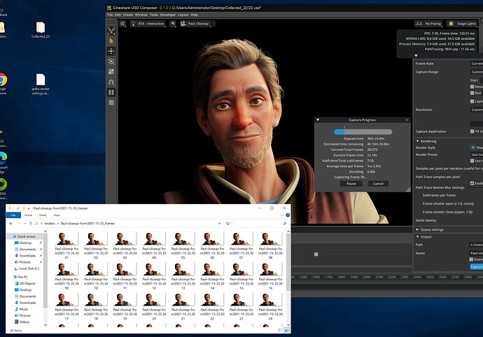

It renders but there are issues with the lines.
Please tell me how can we solve this line issues thing?
Also you can see strange white stuff at the eyebrowses and hair all over.
After rendering a litte while, it will take more gpu to use but still its poor and not efficient:
So need to render this at the very same setup ( win11, same drivers and VM ) but just on 1 L40S:

We are looking into this bug at the moment. I would start by sending us detailed logs of kit 106, when the lines appear. You are not using our recommended AMI so it hard to advise.
As I mentioned before, you would be better off using a machine with less GPUs and renting more of them to balance it out. You could rent and build a small render farm for this, as you mentioned.
We apologize. It is a bad bug. But it hard to reproduce here. It could be the machine, the motherboard, the drivers, even the specific file.
Can you DM me the complete render ready file and I can test on my dual A6000. Have you tried to do this on your own local dual A600O machine, if you have one?

Following your DM to me, and just to update this thread, you MUST select the correct vGPU driver mode. If you want to use an RTX application you will need an RTX vGPU license.
Ok. great. So now I forward this info to aws support and maybe they can help me to change this, right?
Pekka
You can just change this. Just click the RTX one. Unless you have not paid for the right license.
Please can you tell me where this setting is?
looks like it’d be under the NVIDIA Control Panel, assuming the VM has a valid NVIDIA vGPU software license for you to choose from. in your original post, the video you posted at timestamp 0:18 is where you would be able to change it to NVIDIA RTX Virtual Workstation
