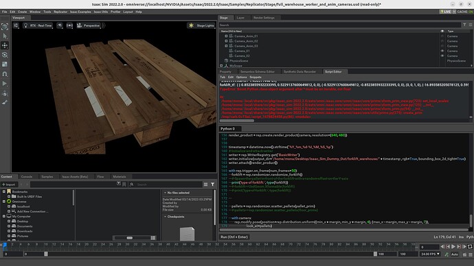

However, it spawns very large pallets. I intend to use scale 0.01 but it seems scatter_2d is not allowing it. How can I fix this problem?
as you can see the pallet is encompassing the warehouse.usd
You would need to use rep.modify.pose. In your case you can pass it in a constant value instead of a distribution.

# Register randomization
rep.randomizer.register(randomize_forklift)
def scatter_pallets(prim):
    # Calculate the bounds of the prim to create a scatter plane of its size
    bb_cache = create_bbox_cache()
    bbox3d_gf = bb_cache.ComputeLocalBound(prim)
    prim_tf_gf = omni.usd.get_world_transform_matrix(prim)
    bbox3d_gf.Transform(prim_tf_gf)
    range_size = bbox3d_gf.GetRange().GetSize()
    # Get the quaterion of the prim in xyzw format from usd
    prim_quat_gf = prim_tf_gf.ExtractRotation().GetQuaternion()
    prim_quat_xyzw = (prim_quat_gf.GetReal(), *prim_quat_gf.GetImaginary())
    # Create a plane on the pallet to scatter the boxes on
    plane_scale = (range_size[0] * 5, range_size[1] * 5, 1)
    plane_pos_gf = prim_tf_gf.ExtractTranslation() + Gf.Vec3d(0, 0, range_size[2])
    plane_rot_euler_deg = quat_to_euler_angles(np.array(prim_quat_xyzw), degrees=True)
    scatter_plane = rep.create.plane(
        scale=plane_scale, position=plane_pos_gf, rotation=plane_rot_euler_deg, visible=False
    pallets = rep.create.from_usd(PALLET_URL, semantics=[('class', 'pallet')], count=2)
    with pallets:
        rep.physics.collider()
        rep.randomizer.scatter_2d(surface_prims=scatter_plane, check_for_collisions=True)
        rep.modify.pose(scale=0.001)
    return pallets
rep.randomizer.register(scatter_pallets)
# Setup camera and attach it to render product
camera = rep.create.camera(
    focus_distance=800,
    # f_stop=0.5,
    f_stop=500,
    #focal_length=613.634
render_product = rep.create.render_product(camera, resolution=(640, 480))
timestamp = datetime.now().strftime("%Y_%m_%d-%I_%M_%S_%p")
# Initialize and attach writer
writer = rep.WriterRegistry.get("BasicWriter")
writer.initialize(output_dir="/home/mona/Desktop/Isaac_Sim_Dummy_Out/forklift_warehouse/" + timestamp , rgb=True, bounding_box_2d_tight=True)
writer.attach([render_product])
with rep.trigger.on_frame(num_frames=50):
    forklift = rep.randomizer.randomize_forklift()
    # Spawn the pallet in front of the forklift with a random offset on the Y axis
    print('type of forklift: ', type(forklift))
    # forklift = UsdGeom.Xformable(forklift)
    # print('type of forklift: ', type(forklift))
    pallets = rep.randomizer.scatter_pallets(pallet_prim)
    # pallets = rep.randomizer.scatter_pallets(floor_prims)
    with camera:
        rep.modify.pose(position=rep.distribution.uniform((min_x + margin, min_y + margin, 4), (max_x - margin, max_y - margin, 7)),
                        look_at=pallets)
Can you please run the above code in Isaac Sim Script Editor?
