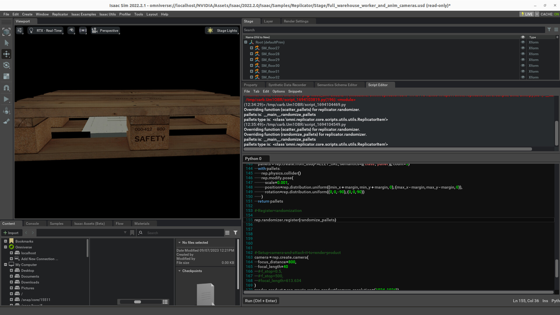

I am using Isaac Sim 2022.2.1 Script Editor interactive SDG using Replicator → Start. I have this code however changing the scale from 0.01 to 0.001` didn’t help in the pallets being inside the warehouse. specifically this section of code:
def randomize_pallets():
pallets = rep.create.from_usd(PALLET_URL, semantics=[('class', 'pallet')], count=5)
with pallets:
rep.physics.collider()
rep.modify.pose(
scale=0.01,
position=rep.distribution.uniform((min_x + margin, min_y + margin, 0), (max_x - margin, max_y - margin, 0)),
rotation=rep.distribution.uniform((0, 0, -90), (0, 0, 90))
return pallets
Could you please guide what part is wrong and how it should be fixed?
# problem with scaling of pallets (pallets encompass the warehouse as of 09.07.2023)

As you see here, the pallet is encompassing the warehouse:
