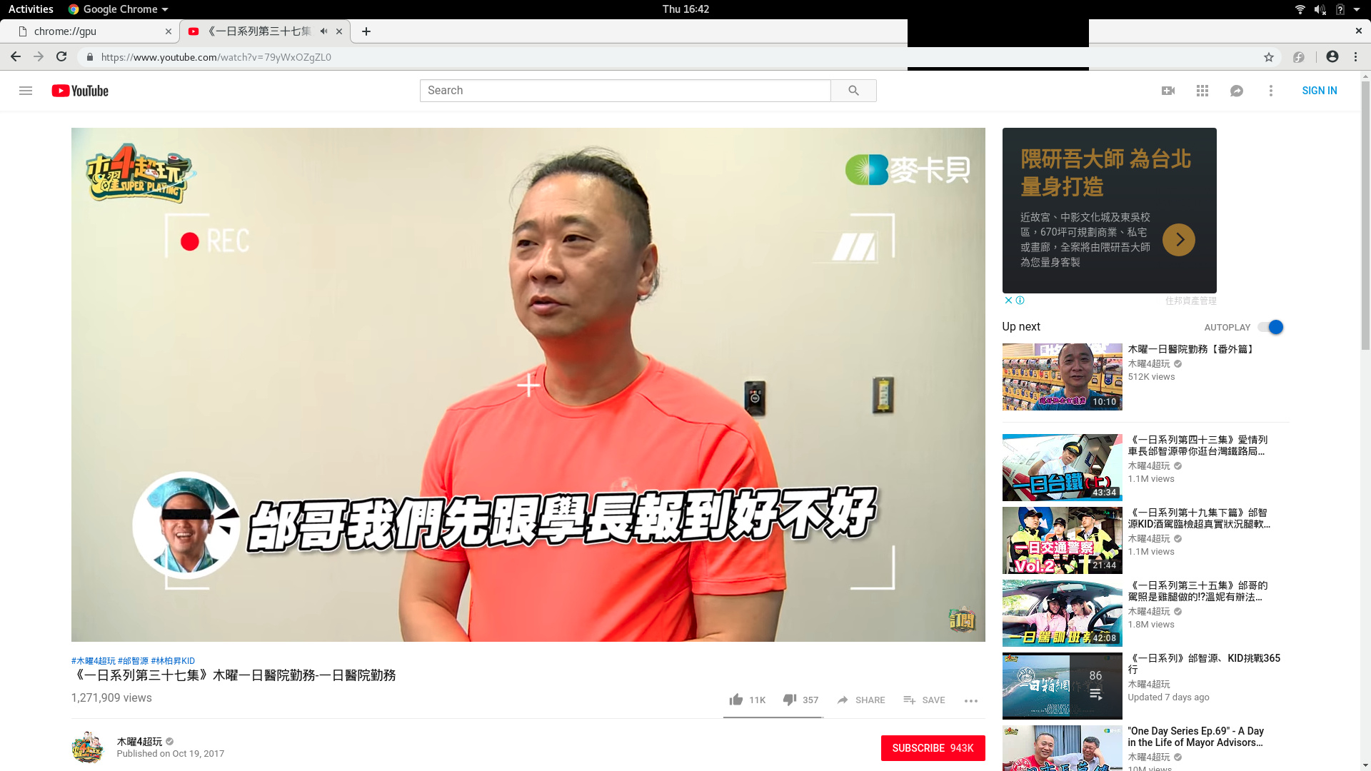

We suspended system during watching a Youtube video in Chrome browser. After the system resumed, we found the screen got corrupted. And this issue can usually be reproduced with the actions.
corrupted images: The two images in the attachments
Here are the error meassages in journal log.
Oct 18 16:41:24 localhost.localdomain google-chrome.desktop[2734]: [2780:2780:1018/164124.868739:ERROR:gles2_cmd_decoder.cc(8216)] [.BrowserCompositor-0xb4bd3572000]GL ERROR :GL_INVALID_FRAMEBUFFER_OPERATION : glFramebufferTexture2D: <- error from previous GL command
Oct 18 16:41:24 localhost.localdomain google-chrome.desktop[2734]: [2780:2780:1018/164124.880325:ERROR:gles2_cmd_decoder.cc(2653)] [.BrowserCompositor-0xb4bd3572000]GL ERROR :GL_INVALID_FRAMEBUFFER_OPERATION : GLES2DecoderImpl::DoBindOrCopyTexImageIfNeeded: <- error from previous GL command
Oct 18 16:41:24 localhost.localdomain google-chrome.desktop[2734]: [2780:2780:1018/164124.913351:ERROR:gles2_cmd_decoder.cc(8216)] [.BrowserCompositor-0xb4bd3572000]GL ERROR :GL_INVALID_FRAMEBUFFER_OPERATION : glFramebufferTexture2D: <- error from previous GL command
Oct 18 16:41:24 localhost.localdomain google-chrome.desktop[2734]: [2780:2780:1018/164124.942283:ERROR:gles2_cmd_decoder.cc(2653)] [.Media-0x2367b30f1a00]GL ERROR :GL_INVALID_FRAMEBUFFER_OPERATION : GLES2DecoderImpl::DoBindTexImage2DCHROMIUM: <- error from previous GL command
Oct 18 16:41:24 localhost.localdomain google-chrome.desktop[2734]: [2780:2780:1018/164124.972883:ERROR:gles2_cmd_decoder.cc(8216)] [.BrowserCompositor-0xb4bd3572000]GL ERROR :GL_INVALID_FRAMEBUFFER_OPERATION : glFramebufferTexture2D: <- error from previous GL command
