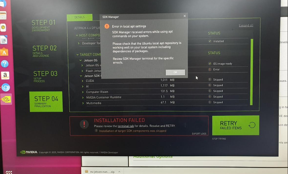

I have stocked in this situation
sdk manager received errors while using apt commands on your system
What am I supposed to do?

Hi neuezeal,
Please manually run “sudo apt-get update” in a terminal and check the output. If there is any error, please fix them first then retry with SDK Manager installation.
