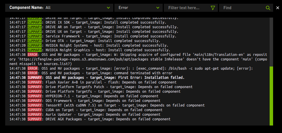

Hi, @shangping.guo
Please compress logs in ~/.nvsdkm directory and attach it here for our analysis. Thanks.

Please fix those errors from http://sd-srv-pxe.sd.tusimple.ai/os/ubuntu and http://ftp.fau.de/trinity/trinity-builddeps-r14.0.0/ubuntu URI in your .nvsdkm/logs/DRIVE_Software_10.0_Linux_OS/NV_OSS_AND_NV_PACKAGES_SDK_COMP.log as below and see if it helps.

Info: [ Package PreInstall Finished with Error ]
Info: [host] [ 9.12 MB used. Disk Avail: 695.52 GB ]
Info: [ NV_OSS_AND_NV_PACKAGES_SDK_COMP Install took 11s ]
Error: [error]: : [exec_command]: /bin/bash -c sudo apt-get update; [error]:
W: Skipping acquire of configured file ‘main/cnf/Commands-amd64’ as repository ‘https://cfengine-package-repos.s3.amazonaws.com/pub/apt/packages stable InRelease’ doesn’t have the component ‘main’ (component misspelt in sources.list?)
W: GPG error: http://ftp.fau.de/trinity/trinity-builddeps-r14.0.0/ubuntu bionic InRelease: The following signatures couldn’t be verified because the public key is not available: NO_PUBKEY C93AF1698685AD8B
E: The repository ‘http://ftp.fau.de/trinity/trinity-builddeps-r14.0.0/ubuntu bionic InRelease’ is not signed.

@VickNV I only fixed the public key problem, for the other NOT_FOUND errors, I do not know how to fix. Is it able to change a source to download? (I guess it gets the source links from somewhere on my computer?) Thanks

Please try if temporarily removing source files in /etc/apt/sources.list.d/ helps.
I guess http://sd-srv-pxe.sd.tusimple.ai/os/ubuntu and Index of /trinity/trinity-builddeps-r14.0.0/ubuntu are in some files there.
@VickNV just did your way, it does not work either

Please provide the current logs for our analysis.
Is there a chance you could try on another host system?
sdklog.tar.gz (2.9 MB)
I am not sure if I can find one host to do it. I will check and see if I can.

I still saw the same errors in your logs.
Before running SDK Manager to install, please fix them and make sure “sudo apt-get update” has no problem.
@VickNV I have fixed the other issues except this:
W: Skipping acquire of configured file ‘main/i18n/Translation-en_US’ as repository ‘https://cfengine-package-repos.s3.amazonaws.com/pub/apt/packages stable InRelease’ doesn’t have the component ‘main’ (component misspelt in sources.list?)
W: Skipping acquire of configured file ‘main/i18n/Translation-en’ as repository ‘https://cfengine-package-repos.s3.amazonaws.com/pub/apt/packages stable InRelease’ doesn’t have the component ‘main’ (component misspelt in sources.list?)
W: Skipping acquire of configured file ‘main/dep11/Components-amd64.yml’ as repository ‘https://cfengine-package-repos.s3.amazonaws.com/pub/apt/packages stable InRelease’ doesn’t have the component ‘main’ (component misspelt in sources.list?)
W: Skipping acquire of configured file ‘main/dep11/icons-48x48.tar’ as repository ‘https://cfengine-package-repos.s3.amazonaws.com/pub/apt/packages stable InRelease’ doesn’t have the component ‘main’ (component misspelt in sources.list?)
W: Skipping acquire of configured file ‘main/dep11/icons-64x64.tar’ as repository ‘https://cfengine-package-repos.s3.amazonaws.com/pub/apt/packages stable InRelease’ doesn’t have the component ‘main’ (component misspelt in sources.list?)
W: Skipping acquire of configured file ‘main/dep11/icons-64x64@2.tar’ as repository ‘https://cfengine-package-repos.s3.amazonaws.com/pub/apt/packages stable InRelease’ doesn’t have the component ‘main’ (component misspelt in sources.list?)
W: Skipping acquire of configured file ‘main/dep11/icons-128x128.tar’ as repository ‘https://cfengine-package-repos.s3.amazonaws.com/pub/apt/packages stable InRelease’ doesn’t have the component ‘main’ (component misspelt in sources.list?)
VickNV
August 18, 2021, 7:31pm
12
Then try if the installation has any problem.
@VickNV tried with errors. The amazonaws error has to be fixed since it prevents the installation:
2:34:07 ERROR: OSS and NV packages - target_image: W: Skipping acquire of configured file ‘main/i18n/Translation-en’ as repository ‘https://cfengine-package-repos.s3.amazonaws.com/pub/apt/packages stable InRelease’ doesn’t have the component ‘main’ (component misspelt in sources.list?)
12:34:18 ERROR: OSS and NV packages - target_image: E: Error, pkgProblemResolver::Resolve generated breaks, this may be caused by held packages.
12:34:18 ERROR: OSS and NV packages - target_image: ERROR: Installation failed.
12:34:18 ERROR: OSS and NV packages - target_image: [error]: [exit_code]: 1: [exec_command]: /bin/bash -c /home/shangping.guo/Downloads/nvidia/sdkm_downloads/drive-t186ref-linux-5.1.6.1-16911241-oss-minimal-sdk.run --nox11 | tee -a /home/shangping.guo/.nvsdkm/logs/DRIVE_Software_10.0_Linux_OS/NV_OSS_AND_NV_PACKAGES_SDK_COMP.log; exit ${PIPESTATUS[${#PIPESTATUS [@]}-2]}; [error_message]: ERROR: Installation failed.
12:34:18 ERROR: OSS and NV packages - target_image: command terminated with error
12:34:18 SUMMARY: OSS and NV packages - target_image: First Error: Installation failed.
12:34:18 SUMMARY: Flash Xavier A+B in parallel - flash: Depends on failed component
12:34:18 SUMMARY: Drive Platform Targetfs Patch - target_image: Depends on failed component
12:34:18 SUMMARY: Drive Platform Targetfs - target_image: Depends on failed component
12:34:18 SUMMARY: HYPERION-7.1 - target_image: Depends on failed component
12:34:18 SUMMARY: DDS Framework - target_image: Depends on failed component
12:34:18 SUMMARY: TensorRT (with cuDNN 7.5) on Target - target_image: Depends on failed component
12:34:18 SUMMARY: CUDA on Target - target_image: Depends on failed component
12:34:18 SUMMARY: Aurix Updater - target_image: Depends on failed component
12:34:18 SUMMARY: DRIVE AGX Packages - target_image: Depends on failed component
