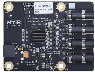

I recently purchased a Jetson Orin Nano Super, and I am trying to use the NVP6324 custom board “MY-CAM004M” to connect four AHD video streams through the CAM1: CSI 1 x2 lane or 1 x4 lane connector on the Jetson Orin Nano Super.
NVP6324 Description and Driver.zip (2.1 MB)
