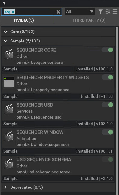

Sequencer is missing in my Kit 108

See there sreecshots, why am I missing the Sequencer?
you should be looking for Sequencer Window. that said, i have to clarify that i am using the kit 108 full app, though i am sure there is a way to make it work with the composer based kit app.
That is not found on my extensions.
How do I install that kit 108 full app ?
you can find the full app in the directory where you set up the kit-app-template: \kit-app-template\_build\windows-x86_64\release\kit\omni.app.full.bat either that or you can add the missing sequencer related extension manually via the extension manager. take it as a grain of salt; Richard will probably have a more straightforward ways to enable it in the composer based app.
Yes, correct. You need to wait for the registry to sync fully, but “Sequencer Window” is there. You can just add it to USD Composer.
That is correct, there it is!
So this is my new main tool :D

After the update and restart the extension is no more visible, just like Richard said I need to wait for the registry rto update..
But it looks like it takes forever:
How can I make sure its really syncing?
Why did it disappeared after the installation of the Hub?
I cannot see any info about syncing the registry:
They appeared there finally after many minutes, I have now the sequencer :D

I am glad you got it to work. Yes the registry is a bug right now, with the sync speed.
You are mixing threads here, but for your last post on the character you have to also enable “omni.kit.property.skel” and toggle the Mode back and forth one time.
Me stupid!
I waited now for the registry to update, and there is it!! Case solved, thanks @Richard3D and @Simplychenable !!
