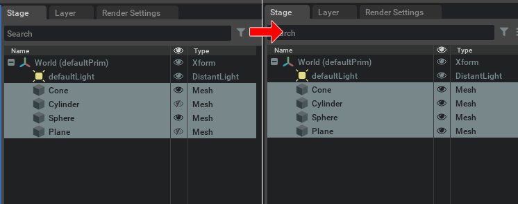

When I specified Show/Hide (inherited/invisible) for multiple prims in the Stage window and toggled this state in Script, it did not work properly.

The result is as follows.
Visibility is not inverted.
This example shows the placement of four Prims.
I specified inherited/invisible/inherited/invisible and selected these four Prims to run the script.
Then, everything was selected.

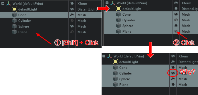

However, I got similar behavior when switching Visibility without using scripts.
Currently, I am not sure if this problem is due to the UI or the USD SDK.
