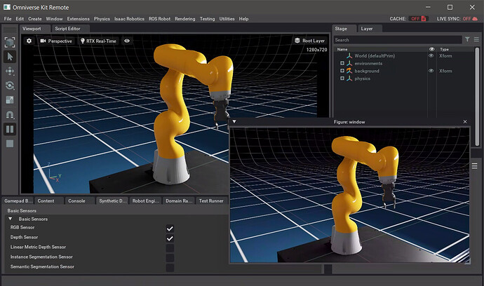

Hello for anyone interested
There is an extension that helps to generate and visualize OpenCV, Matplotlib and Omniverse native images and data in a quick and popular way (OpenCV-like and Maplotlib-like interface). This is very useful for remote workstation deployment (I think 😅)…
This extension uses as backend the new omni.ui module in 2020.2
You can find it here: GitHub - Toni-SM/semu.data.visualizer: Display Matplotlib graphics and OpenCV images inside NVIDIA Omniverse apps
Some images about the functionalities:
OpenCV-like interface
2D Matplotlib-like interface
3D Matplotlib-like interface
Omniverse native interface
